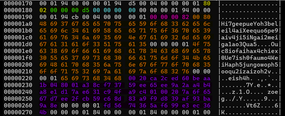

Compared to Windows BitLocker that uses command 0x00000158 for TPM2_Unseal,LUKS on this Moxa device uses 0x0000014E for TPM2_NV_Read:
  1. The key is stored directly in a TPM NV index, not sealed as an object like the Volume Master Key (VMK) in BitLocker
  2. What comes back is the actual LUKS passphrase (here a 128-byte ASCII string), not an intermediate key, so a little more straight forward than decrypting the Full Volume Encryption Key (FVEK) with the VMK to finally decrypt the disk
  3. PCR policy still gates access, but the mechanism is NV read authorization rather than unsealing
In this nice read, we can discover that the key (in orange) is directly joined after the policy-protected NV index using the TPM2_NV_Read command:
(source: https://www.cyloq.se/en/research/cve-2026-0714-tpm-sniffing-luks-keys-on-an-embedded-device )
Which could probably inspire us for other devices in the wild 🙂
