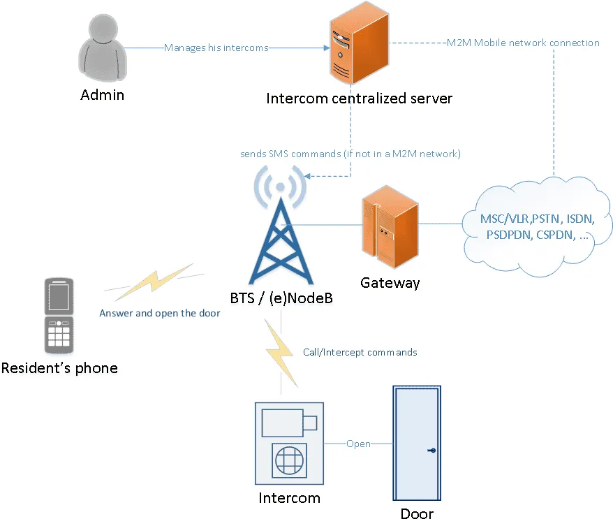

These intercoms use the following Machine-2-Machine mobile network architecture.
M2Mintercom
M2M intercom architecture shown at Hack.lu 2016 and 33c3
As discussed at Hack.lu 2016 and also 33c3, any vulnerability found in this server, or any third party connected to this server, would give interesting access for an attacker that would be able to open an important number of frontdoors at the same time. During this talk we also showed a vulnerability that enabled us to control a large amount of intercoms remotely with just a simple internet connection. Moreover, the vendor provides a valid M2M SIM card with 10 years validity that is used by the intercom to connect to internet. That M2M SIM card is protected by a PIN that can be recovered with a SIMTRACE tool, and then plugged in a phone to tether the connection. In some contexts, this connection will give further accesses to the vendor virtual mobile network by using the right APN (Access Point Name).

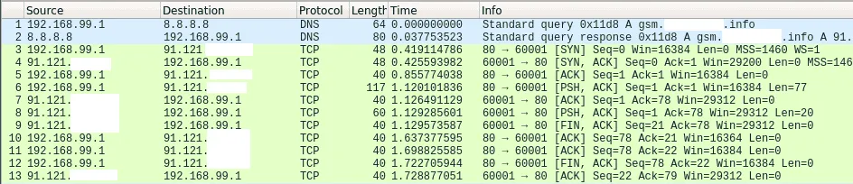

In the case of 3G intercoms, the capture of data exchanged with remote servers is mandatory, so the GPRS should be activated in YateBTS configuration file ybts.conf as follows:
[gprs]
Enable=yes
The configuration relative to the Gateway GPRS Support Node is also needed. This will handle exchanges between our GPRS network and our Internet connection. The configuration can look as follows:
[ggsn]
DNS=8.8.8.8 8.8.4.4 ; its preferable to use your own servers for client side attacks
IP.MaxPacketSize=1520
IP.ReuseTimeout=180
IP.TossDuplicatePackets=no
Logfile.Name=/tmp/sgsn.log
MS.IP.Base=192.168.99.1
MS.IP.MaxCount=254
TunName=sgsntun
Then as usual, we have to tell the kernel to allow IP forwarding, and then iptables to forward the traffic from the internal network:
# echo 1 > /proc/sys/net/ipv4/ip_forward
# iptables -A POSTROUTING -t nat -s 192.168.99.0/24 ! -d 192.168.99.0/24 -j MASQUERADE

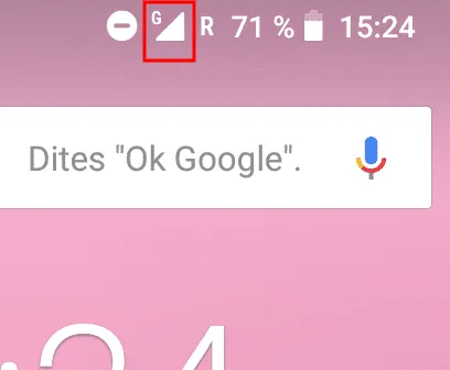

This configuration allows to register to our fake GPRS network with a mobile phone by scanning operators, and registering the cellphone to the network.
Note: If the BTS (Base Transceiver Station) is running with a Mobile Country Code (MCC) and Mobile Network Codes (MNC) codes different from the one associated to our SIM/USIM card operator, it will be necessary to activate the itinerary feature (as it is already the case with Free Mobile users for example) to allow data on the created network, or change the codes to correspond to your SIM/USIM card operator.
Once the running BTS correctly configured, the mobile phone be then able to browse the Internet. This is indicated with the tiny icon showing the phone is actually connected througt GPRS.
GPRSturnedon
Cellphone connected in GPRS

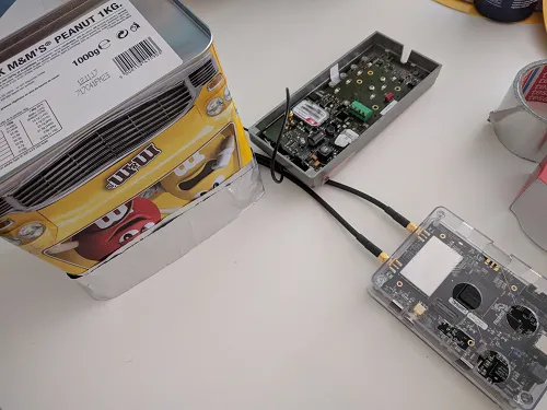

mmsboxmetal
M&Ms box we have to empty before using it as a Faraday shielding
From experience, if you put your phone on a good metal box and close the lid for few seconds, the cellphone will loose the signal from base stations around.
Once you have eaten all of the M&Ms, the complete bladeRF can fit in the box, but it is recommended to only put antennas is this box to keep some space inside. Note that it is important that the seal between the lid and the box is tight and consolidated with aluminum foil tape, and any holes covered with the same foil tape. Before putting the targeted device in the box with the running BTS, YateBTS’s configuration has to be changed to avoid any damage on the receiving side. To do so, we have to lower down the parameter Radio.PowerManager.MaxAttenDB of ybts.conf to the minimum and increment the value by step until it is detected by the targeted device.

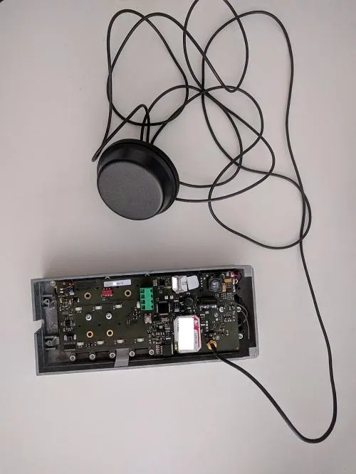

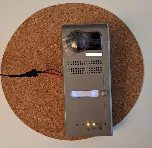

Sometimes, the targeted device won’t fit in the box. So here is what we did with the intercom by including an external antenna:
ExternalAntenna
External antenna access on the intercom
With this intercom the position of a switch close to the antenna must be flipped to use the external antenna.
The final set-up should look like this:
MMsFaradayBox
The Faraday M&Ms box (made in France) with an aluminum foil tape enclosure to make a contact with the lid
This Faraday M&Ms box works really great in our case, but in other contexts the use of a custom SIM/USIM card could be also be efficient and less tricky.
Method 3 – Using a custom SIM/USIM card
In some cases, the access to the SIM/USIM card is not possible or very hard (e.g: current Sierra modems). But when it is possible, this method should be considered first, because it excludes the user equipment from contacting any legit operator. This could save any missed packet sent on a initialization state of the device for example.
Generally, prepaid USIM/SIMs card from other countries that do not accept roaming could work to perform the isolation. But you can also opt for a sysmo SIM/USIM card made to be freely programmed.
Caution: some devices are forcing Personal Identity Number (PIN) code typing. In that case, it is recommended to sniff the PIN typed by the device with a SIMTRACE, as presented our talks since Hack.lu 2016. That would prevent your custom SIM/USIM card from being blocked, and typing a PUK (Personal Unblocking Code) code to unlock it.
Note also that in this case, it is also possible to use a rogue (e)NodeB capture the data in 3G, or 4G without problem. But we will stick to our GSM/GPRS BTS for this article.
Capturing and analyzing GPRS data
Once the target is trapped on our network, we will be able to capture its data exchanged with other servers.
By using one of the isolation method above, we are able to trap the device on out network, and intercept its communications.
For example, we can observe in the following capture that our network associated a Temporary Mobile Subscriber Identity (TMSI) with the targeted International Mobile Subscriber Identity (IMSI):

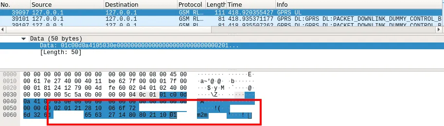

Capturing the GSMTAP queries, it is possible to get the APN used by the device as follows:
GSMtapAPN
Capture of the APN on the GSMTAP interface
By capturing the traffic with Wireshark on the tun interface created for the SGSN, in our case sgsntun, it is possible to intercept messages exchanged between the intercom and servers on Internet:
SGSN_clocksync
Capture of exchanges between the intercom and servers
In the capture, it is possible to notice that only 2 different TCP ports are queried on a unique server to synchronize our intercom. Queries on port TCP 60001 seems to be dedicated to clock synchronization. Indeed, when requesting the service as follows multiple times, we get the current time:
In [1]: import socket
In [2]: import binascii
In [3]: ip = '91.121.XXX.XXX'
In [4]: port = 60001
In [6]: s = socket.socket(socket.AF_INET, socket.SOCK_STREAM)
In [7]: s.connect((ip, port))
In [8]: s.send(binascii.hexlify("011e4d25636014006600000000000000090000011e1540XX[...]"))
Out[8]: 320
In [9]: data = s.recv(1024)
In [10]: data
Out[11]: '2018/09/07 15:09:01n'

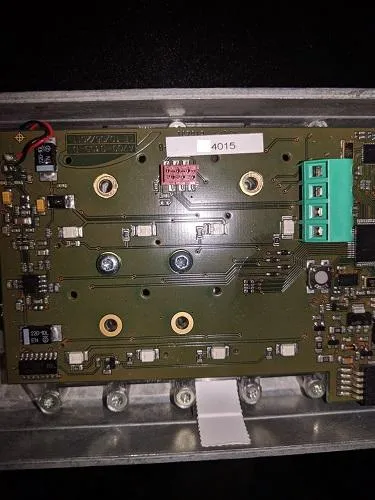

By looking at the devices stickers, it is possible to notice the ID number of the intercom is included in the requests (in the little endian format 1540XX) as follows:
deviceID
ID of the device used in queries
So our supposition is that only this number identify the device from others. But for this particular service, impersonating an intercom is not really interesting.

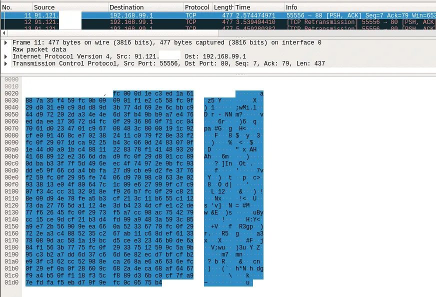

Looking at captures, we can observe the port 55556/tcp is also running a service on the same remote server. With this intercom, the payload sent for the service 55556/tcp is the same as 60001/tcp we mentioned earlier. But on this last port, changes on the administration web panel have to be made to make talk to the intercom. This data is potentially generated to update the intercom. However, the data sent by this service is not really clear:
ciphereddata
Analyzing quickly the payload with ent, the payload sent by the server for updates seems to be encrypted:
$ ent payload.hex
Entropy = 7.371044 bits per byte.

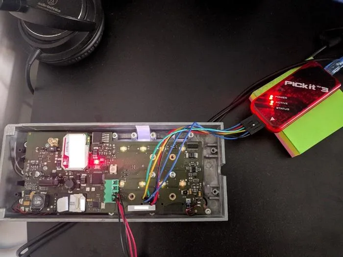

By looking on the Printed Circuit Board (PCB) of the intercom, we can notice 4 interesting components:
  • A SIM/USIM slot (yellow);
  • The 3G modem (blue);
  • The MCU (Microcontroller Unit) (green);
  • A strange interface (red);
components
Important components of the PCB

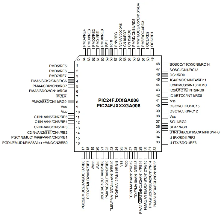

As pentesters, our first reflex is to identify the exposed interface. Many ways exist and for the most commonly used devices, such as routers, an invaluable resource is /dev/ttys0’s blog. About IoT devices, this year at the French conference SSTIC, Damien Cauquil has also presented his feedback when attacking IoT devices that the the Bluetooth Low Energy, and techniques that could be used to identify interesting components on devices PCB.
Before doing anything, we need to identify the MCU family and its version. Even with good eyes and good light, this information is difficult to get but with persistence, its possible to decode the following writing: Microchip – PIC24FJ128 – GA006.
Then with that information we have to look for the documentation of this particular MCU, that could be found in the following PIC24FJ128GA010 family datasheet.
The targeted interface has 6 PINs. At first sight, we can think it is maybe a JTAG interface, but a continuity tests with a multimeter reveals something else. Indeed, this interface is connected to the following pins (which is completely different from the expected JTAG):
  • PGC1 (pin 25);
  • PGD1 (pin 16);
  • Vdd (pin 38);
  • /MCLR (pin 7);
  • AVss (pin 19).
PIC24FG128GA006
Legs of the PIC24FG128GA006 MCU
The MCU datasheet informs us that those pins are meant for “In-Circuit Debugger and ICSP Programming Clock”. To communicate on this port a PICKit 3 In-Circuit Debugger can be used (~20€).
We can then connect the PICKit 3 to the intercom debugging and programming interface as follows:
pickit3_connect
PICKit 3 connected to the intercom programming interface
The setup is now complete and we can dump the firmware.

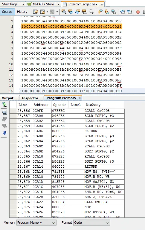

The PICKit 3 In-Circuit Debugger can be used with an IDE software called “MPLAB X” to debug, program, and to read/dump the memory (the firmware).
The software is freely available at: http://www.microchip.com/mplab/mplab-x-ide.
With this software, we are able to read the memory, and export it to a file we can name IntercomFirmware.hex and get data in Intel Hex format as follows:
$ cat IntercomFirmware.hex

With some difficulties we are also able to spot the intercom ID number XX4015:
00017d80  15 40 XX 00 80 4a 78 00  63 00 60 00 66 40 78 00  |[email protected].`.f@x.|

Unfortunatelly for us, trying to disassemble the code with IDA, metasm, RetDec, or radare2 does not product satisfying results. Indeed, IDA support PIC 12XX, PIC 14XX, PIC 16XXX and also 16-bit microcontrollers like the PIC 16XX family, but does not recognize any of PIC 24XX family. Also radare2, known to support exotic architectures, only supports PIC 14XX and PIC 16XX. Metasm on the other hand seems to support PIC 16XX only and its concurrent Miasm2 does not even know what PIC is. On the overside RetDec only supports 32-bit architectures like PIC32, but still there is not support for PIC24.
After spending quite a lot of time looking for all possible reverse engineering tools (this reminds us the opening keynote of Halvareflake at SSTIC 2018), it seems that MAPLAB X IDE is the only software capable of reading the assembly of this firmware without spending too much time writing an engine for IDA, miasm, metasm, etc.
So using the official IDE, we are able to read the memory of the intercom and decode its assembly code as follows:
codeMLABX
Disassembly code of the firmware in MAPLAB X IDE

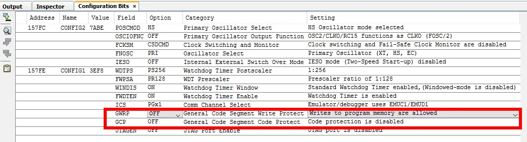

By the way, it is also possible to get the configuration bits of the MCU. This information could be helpful to check security configuration features during an intrusion test, or configuration test:
ConfigurationBits
Configuration bits of the MCU
We can see that the JTAG is clearly disabled, but there is no code nor writing protection activated. That explains also why we are able to dump the MCU’s memory.

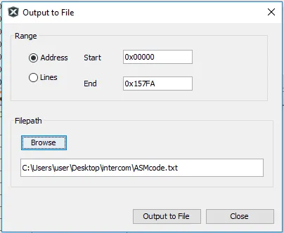

But reading the code in the IDE is not really comfortable, and luckily MAPLAB X IDE allows to export the disassembled content to a text file:
exportASMcode
Export of the ASM code into a file
Open the exported file in your favorite text editor:
