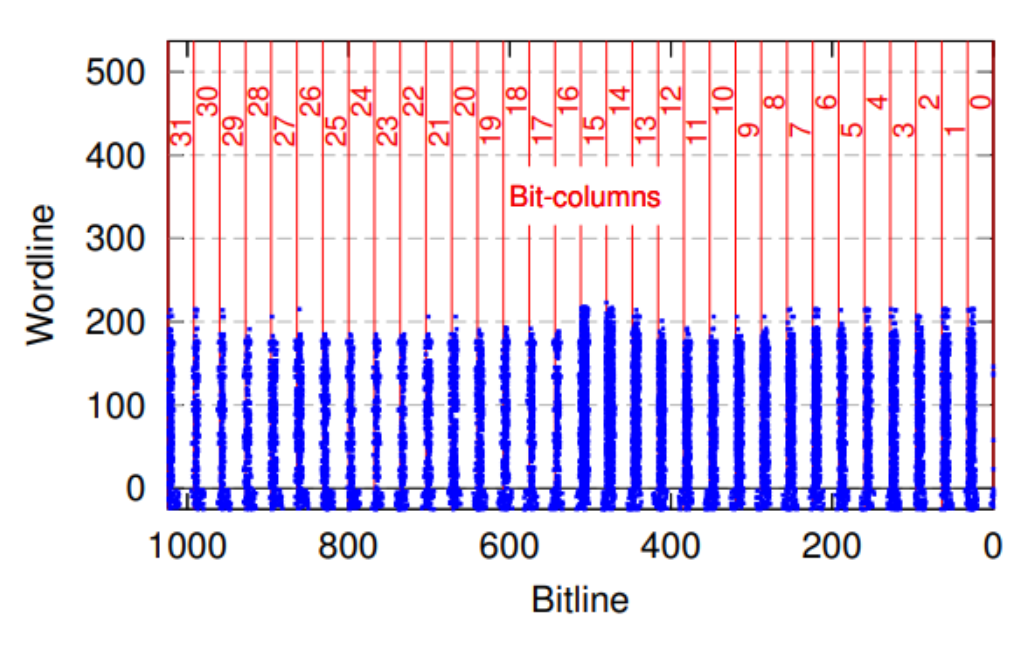

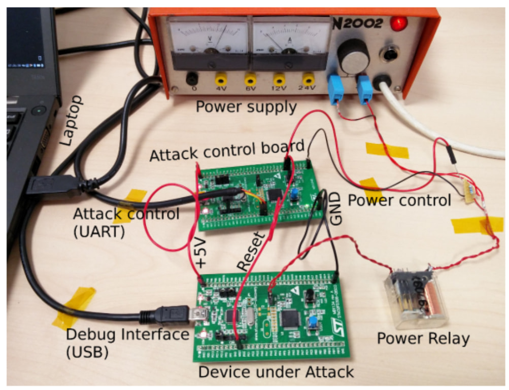

1. UV-C Optical Fault Injection (Level 2 → Level 1 downgrade) RDP level is stored in option bytes in flash. Exposing a decapped chip to UV-C light selectively discharges protection bits, downgrading Level 2 to Level 1. Invasive (requires decapsulation), but the first demonstrated path from “permanently locked” to “attackable.”
Flash layout containing flipped bits (blue) after UV-C irradiation while the upper half was covered
(source: https://www.usenix.org/system/files/conference/woot17/woot17-paper-obermaier.pdf)

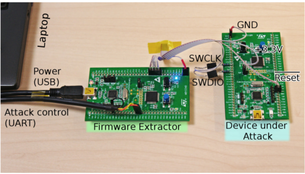

3. Cold-Boot Stepping (Level 1 data leakage via SRAM) If firmware performs a CRC integrity check at boot, intermediate CRC values pass through SRAM. Since SRAM remains readable under RDP Level 1, an attacker can power-cycle with precise timing, read the CRC state, and back-calculate flash contents byte by byte.
PoC setup for CBS
This last technique doesn’t require any silicon bugs -> it exploits a design-level assumption: that leaking processor state and SRAM is not equivalent to leaking flash.

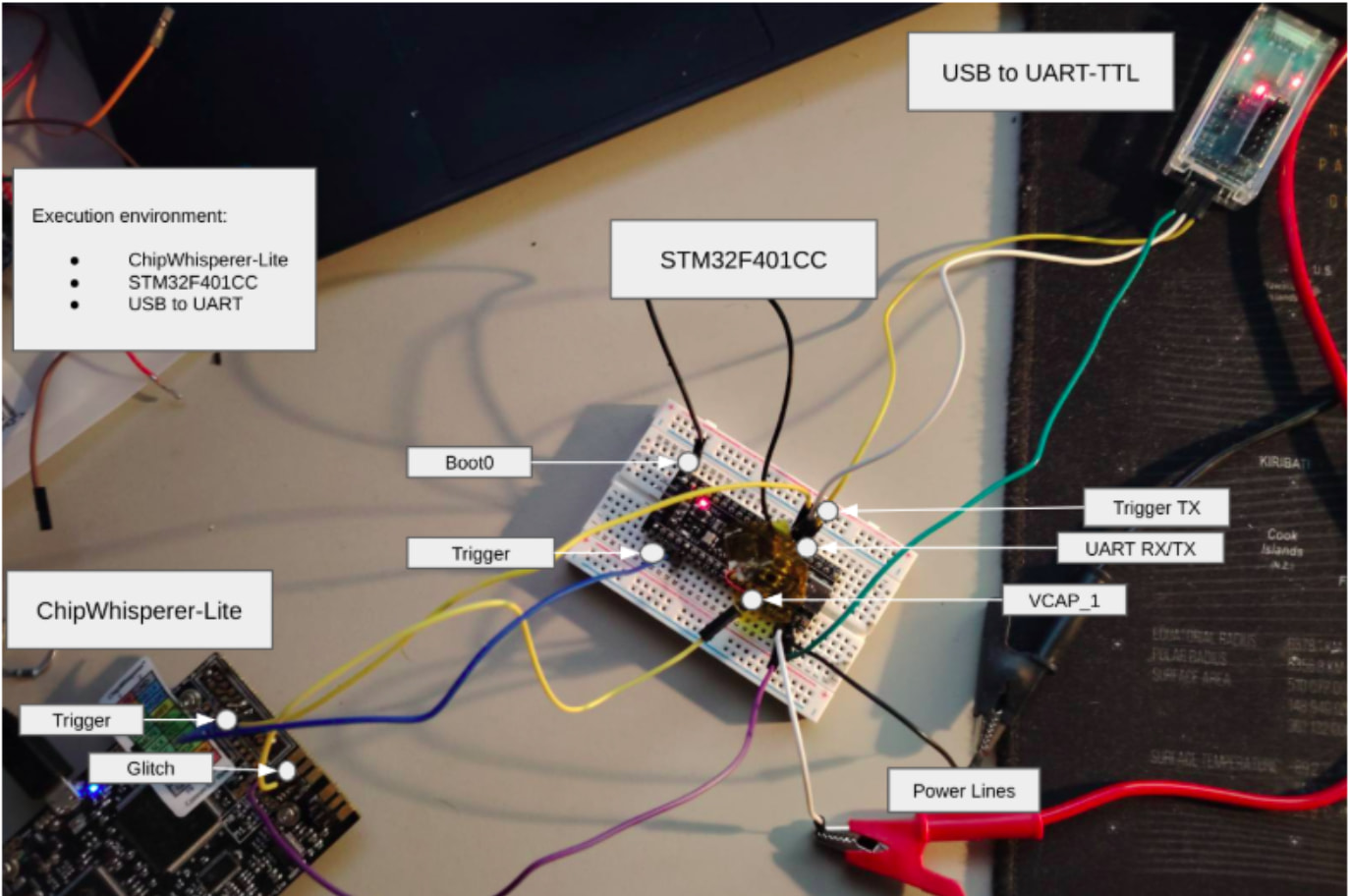

As earlier logic-level exploits got patched, researchers turned to voltage fault injection (VFI).
  • Shaping the Glitch (TCHES: https://tches.iacr.org/index.php/TCHES/article/view/7390): glitching the supply at the moment the bootrom reads RDP option bytes causes the protection level to be misread. On the STM32F1, a glitch just after boot start downgrades RDP. Similar windows found on F3/F4,
  • The chip.fail / Trezor Attack (STM32F2: https://voidstarsec.com/blog/replicant-part-1): perhaps the most famous attack: glitching the Trezor One wallet’s STM32F2 approximately 170 µs into boot bypasses RDP2, exposing SRAM with wallet seeds. Famously replicated by Joe Grand for recovering significant cryptocurrency funds,
  • SECGlitcher (SEC Consult, 2024: https://sec-consult.com/blog/detail/secglitcher-part-1-reproducible-voltage-glitching-on-stm32-microcontrollers/): built on ChipWhisperer, making voltage glitching reproducible and accessible. their conclusion: the STM32 series must be considered insecure against physical attacks when only RDP is relied upon.
  • STM32L051 Flash erase suppression mechanism vulnerability (SySS, 2025: https://blog.syss.com/posts/voltage-glitching-the-stm32l05-microcontroller/): targeting the RDP downgrade routine to suppress the flash erase while lowering protection. Risky (failed attempt erases everything), but effective,
  • Glitching STM32 RDP (Anvil Secure, 2025): clean end-to-end VFI walkthrough on STM32: anvilsecure.com/blog/glitching-stm32-read-out-protection

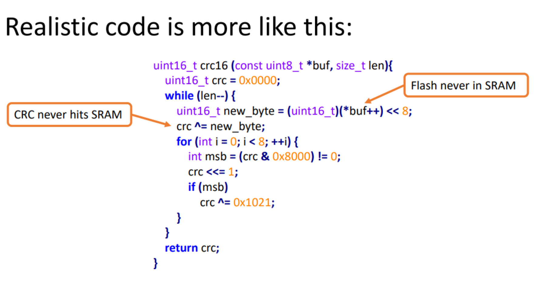

First they tried recovering bytes from a CRC stored in SRAM -> the Cold-Boot Stepping approach from Obermaier’s 2017 work.
The idea: if the bootloader computes a CRC over flash at startup, the intermediate CRC value sits in SRAM, which is still readable under RDP Level 1. Read it at different points in time, back-calculate the flash byte by byte.
But… it didn’t work. The reason? Obermaier’s reference CRC code passed the accumulator by pointer (uint32_t * const crc), which forces the compiler to store it in SRAM. Real-world CRC implementations don’t do that -> the accumulator stays in a CPU register, and flash data is fetched directly into the processor. Nothing interesting ever hits SRAM.

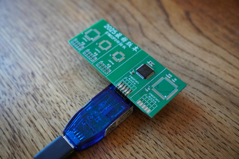

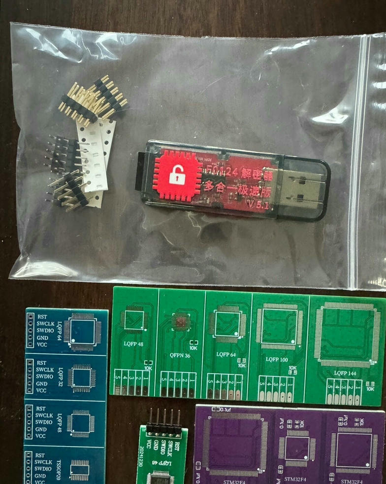

Karolis Stasaitis (@carlossless) recently documented something interesting: while browsing Xianyu (闲鱼, China’s second-hand marketplace), he found a whole market of turnkey STM32 RDP1 “decryptors”: search for “STM32解密” and you’ll see dozens of listings.
For about 150 yuan (~19 EUR), you get a USB dongle, adapter PCBs for F0/F1/F2/F4 packages, and a Windows utility. Solder the chip on the adapter, plug it in, click a button -> full flash dump. No glitching rig, no tuning parameters, no understanding the underlying attack. It just works.
STM32F205RBT6 soldered onto the adapter board and plugged into the dongle

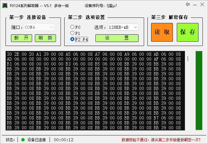

He tested it on an STM32F205RBT6 with RDP Level 1 enabled and got a clean 128KB flash readout at room temperature: the seller’s recommendation to use freeze spray wasn’t even necessary. The only quirk was the tool overshooting past the flash boundary and padding with 0xFF, but the actual contents were correct.
the host Windows application showing a successful flash readout
The dongle has an SOP-16 IC with its markings scraped off, and the Windows app triggers Defender and requires Chinese Simplified encoding to run, so the UX isn’t exactly polished. But the point stands: what took research labs, custom rigs, and careful timing a few years ago is now a commodity product on a Chinese flea market.

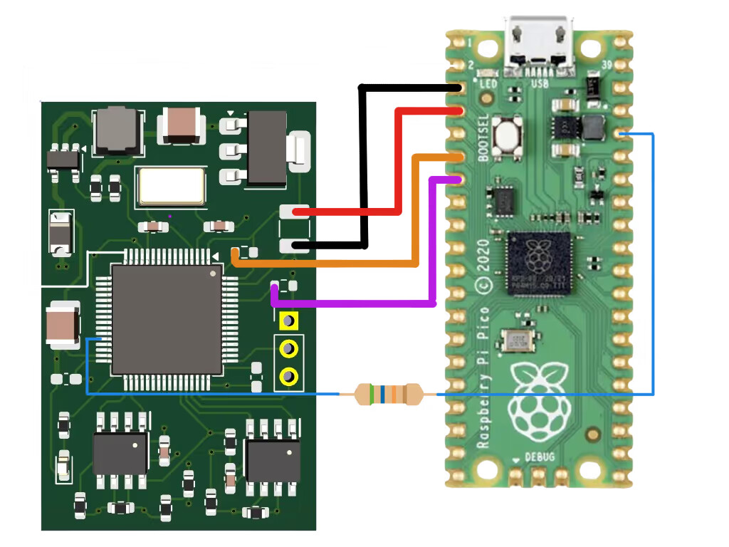

Already reproduced on Pi Pico?
This dongle seems to package what already exists in some open-source implementations:
  • STM32F1 on Pi Pico: stm32f1-picopwner by CTXz: full implementation of the Glitch & FPB attack, tested on Blue Pill boards. Includes the two-stage SRAM payload, SWD bit-bang via the Pico, and a Python dump script,
  • STM32F4 adaptation: stm32f4-rdp-workaround by lolwheel: confirms freeze spray is needed for F4. Author used an ESP8266 for the power glitch with just consecutive digital writes, no delay,
  • STM32F0 debug race: stm32f0-pico-dump by racerxdl: exploits the F0-specific debug interface race condition (first bus access succeeds before RDP kicks in), one DWORD per power cycle,
  • Original attack code: f103-analysis/h3 by Obermaier: the reference implementation that the dongle likely packages.
Block Harbor also has a nice write-up using picopwner on a real-world target (odometer manipulation investigation on an STM32F105).
setup STM32 to Pi Pico
(source: blog of Block Harbor)
Feel free to share your experience, or experiments with these technques! And maybe if I get this dongle, I will be able to tell more about it 🙂 but for now I’m just indexing stuff here.

This raises an interesting commercial question about the dongle: does it actually support GD32 clones? If so, it almost certainly uses also voltage glitching? In addition to the FPB trick used for genuine STM32s. If it doesn’t, then it’s quietly relying on the fact that most buyers won’t notice, or care about the distinction.
