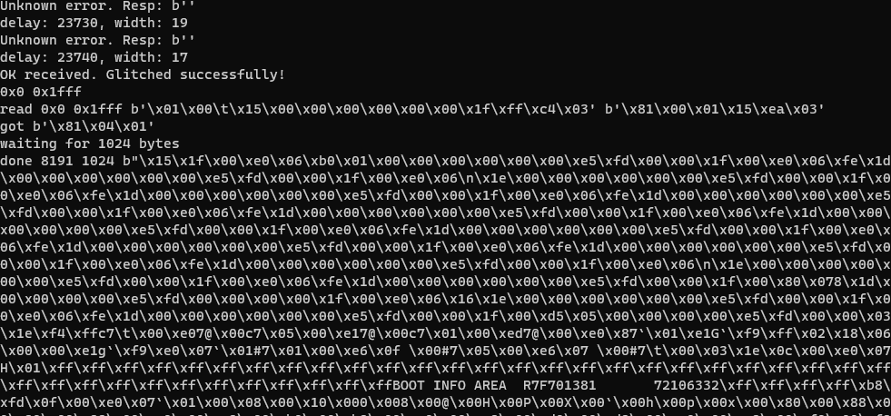

The glitch
Using the NUCLEO-F429ZI platform, and running at 180 MHz with a full FINE protocol implementation, and generating the glitch trigger he could be precise enough to target the ID check window.
Remaining setup:
  • Target pin: VCL: the external capacitor pin for the RX65’s internal core voltage regulator. Same principle as all the research that follows: remove the decoupling cap to make the internal rail directly injectable via a transistor.
  • Trigger timing detail: the timer is started just before the last byte of the “Serial Programming ID Code Check Command” is sent -> starting at the very end would be too late to inject in the right window.
By looping over a trigger offset ~50 times, incrementing and repeating over the time he could recover the option-setting memory contents, with the ID Code sitting at addresses 0xFE7F5D50–0xFE7F5D5F, later confirmed by disassembling the bootloader in Ghidra with the red ballon RX processor extension.
But then he goes further: using the same glitching approach on the Read Command, he bypasses the address access checks (which normally return error 0xD0 for forbidden regions) and dumps the reserved areas -> finding the bootloader itself. What starts as an ID code bypass turns into a full bootloader extraction 🙂 -> very nice!

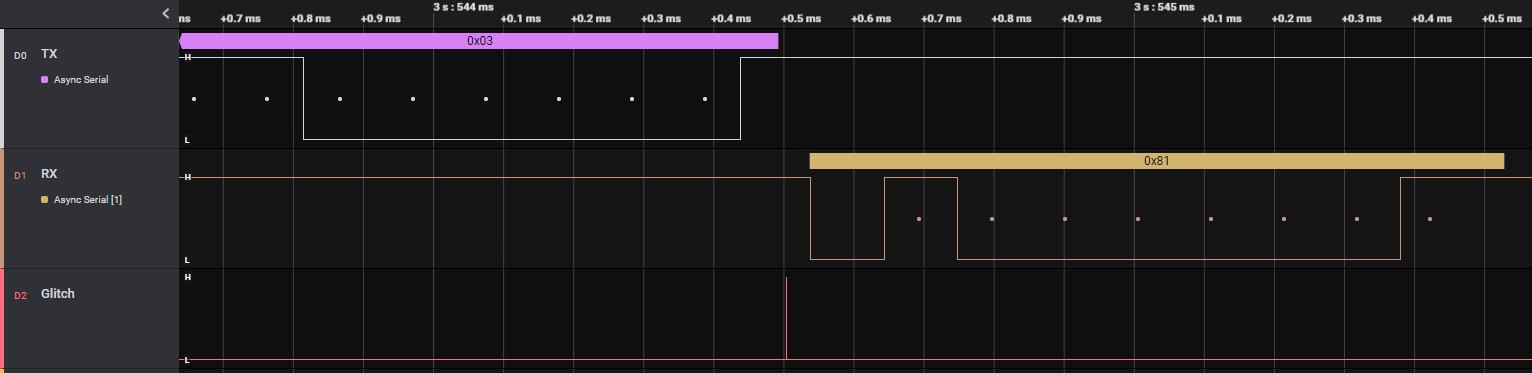

The approach and setup:
  • 2-wire UART interface (FLMD0 pulled high),
  • Timing window: ~100 µs between the last byte of the SYNC command and the error response 0xDC,
  • Minimal hardware: a Raspberry Pi Pico (RP2040) + two N-FETs on the VCL pins (internal regulator), decoupling capacitors removed,
  • Trigger: UART pattern monitoring directly in the RP2040 firmware (wait for SYNC command bytes, then calibrated delay + pulse).

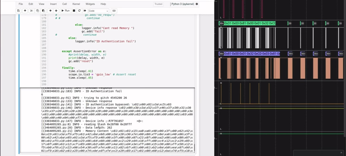

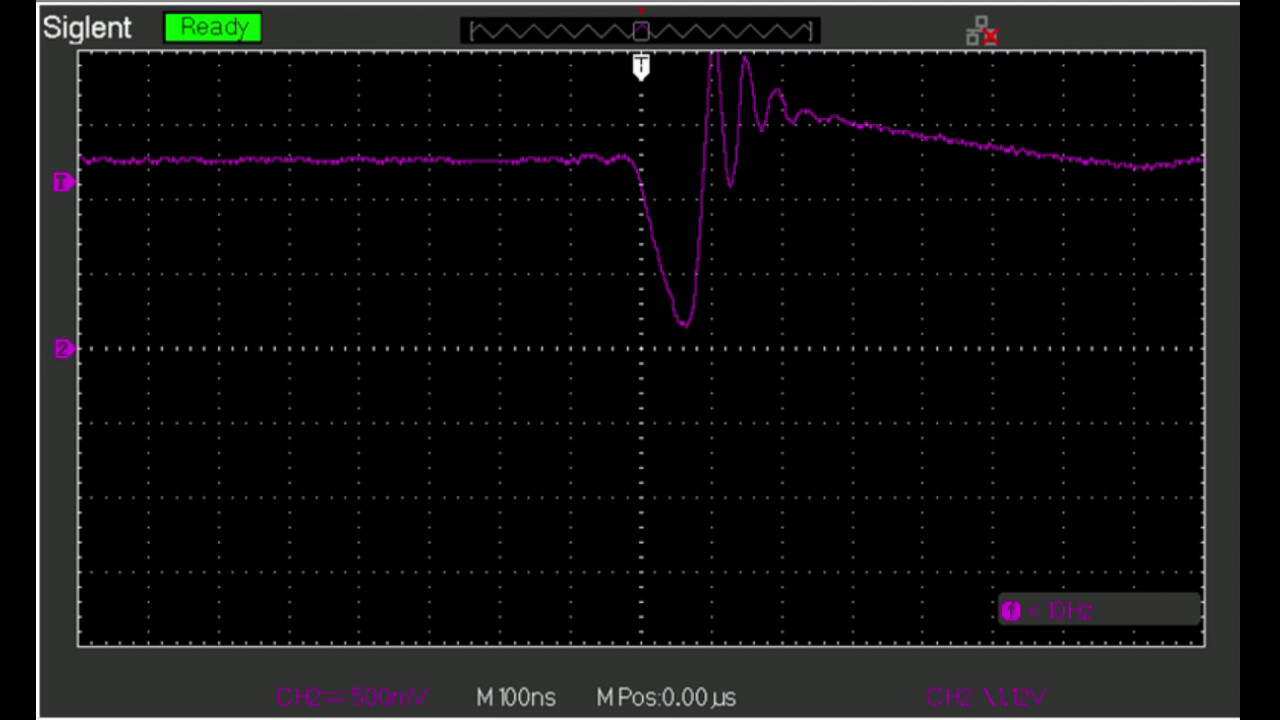

A Python script on the PC to sweep glitch parameters. After about a day of searching, he dumps the entire firmware.
(source: https://icanhack.nl/blog/rh850-glitch/)
Willem later tested glitching only a single VCL pin. Glitching pin 11 alone still works. But glitching only pin 66 produces a curious asymmetric result: it gets past the SYNC command, but memory reads subsequently fail with a flow error. The exact reason isn’t fully explained, likely related to which core (main vs. checker) each pin belongs to, but it hints that the two cores are not fully equivalent from a glitching perspective.

March 2026: Quarkslab with Reliable ID Code bypass
This brings us to the freshly published work by Philippe Azalbert at Quarkslab: Bypassing debug password protection on the RH850 family using fault injection.
They tackle the problem Willem had left open: bypassing the ID Code (the 16-byte password). The target is an RH850/F1KM-S4 (G3KH core, 240 MHz, ASIL-B), a different and faster chip than the one used by Melching.

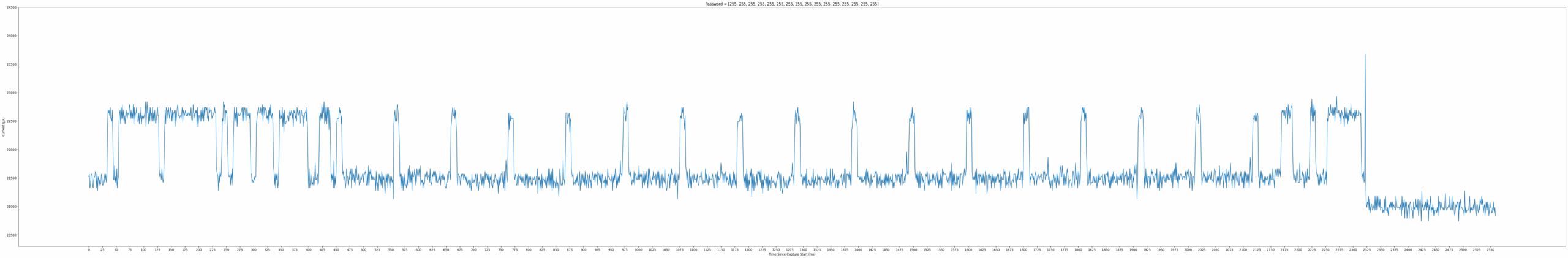

The Trigger Problem

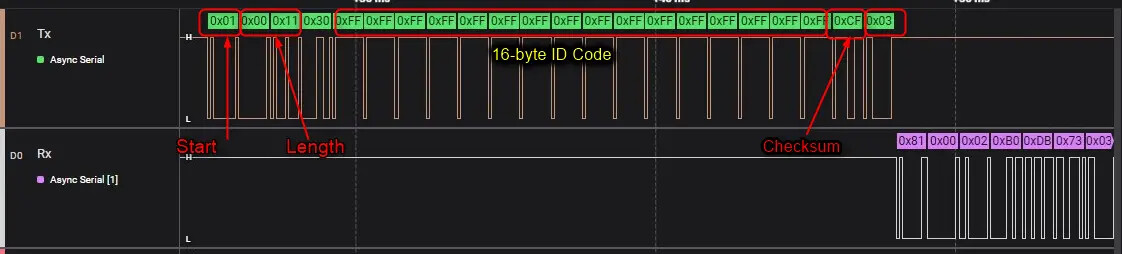

This is the core contribution of the paper. Using the byte before the password checksum as a UART trigger works in principle, but introduces a ~80 µs jitter, likely a random anti-glitch delay baked into the RH850. Too unreliable to use directly.

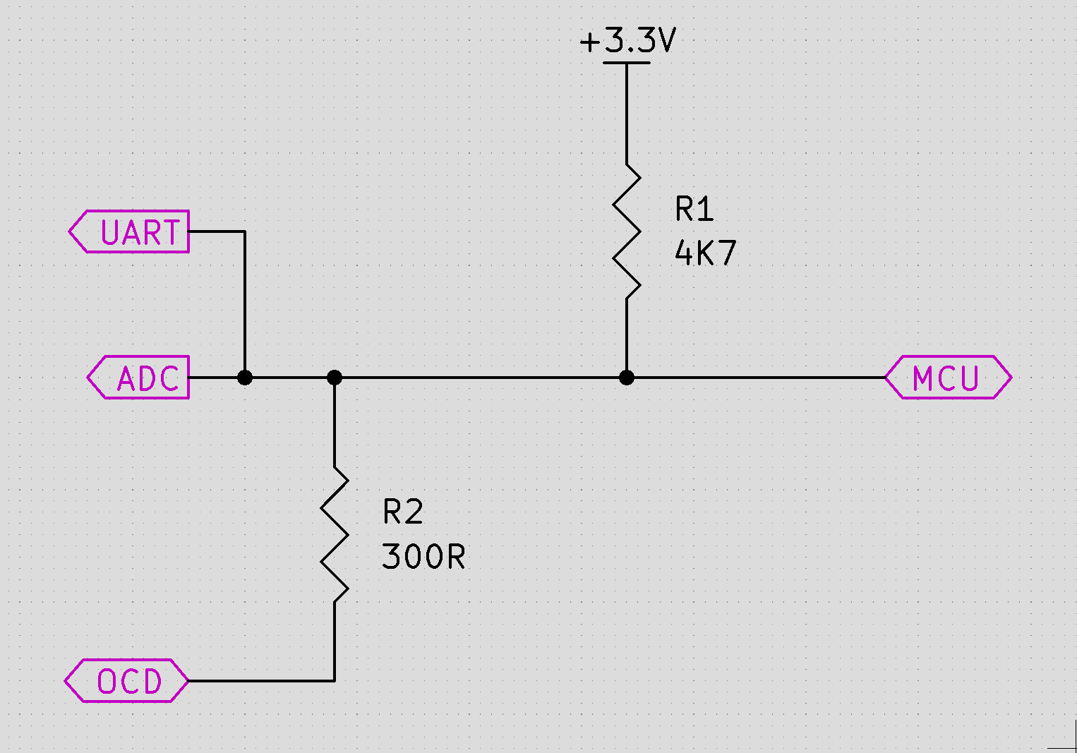

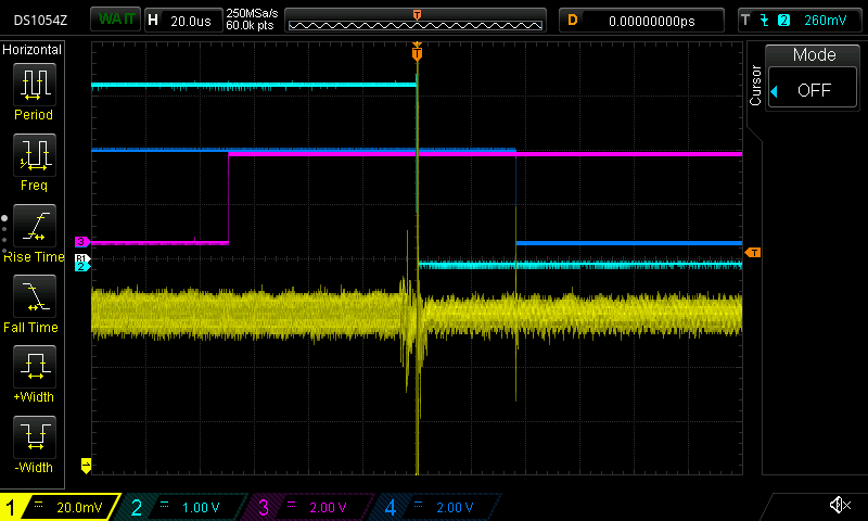

The solution: Simple Power Analysis (SPA) on the ISOVCL pin (the ISO internal regulator, which powers the CPU subsystem and Code Flash). They identify a ~4 µs pattern in the power trace that corresponds to the password verification routine. Importantly, this pattern is consistent across multiple ECUs, validating the approach for real-world cross-device use.

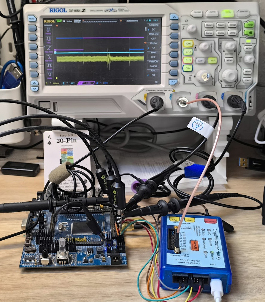

Sequenced Trigger on ChipWhisperer Husky
To exploit this pattern, they use the trigger sequencer of the ChipWhisperer Husky first:
  1. First stage: UART trigger on the last byte of the ID Code frame,
  2. Second stage: ADC trigger on the power consumption spike (at 80% of the measured peak level)
(source: https://blog.quarkslab.com/bypassing-debug-password-protection-on-the-rh850-family-using-fault-injection.html)
Result: bypass in 88 attempts, roughly one minute. Neat!

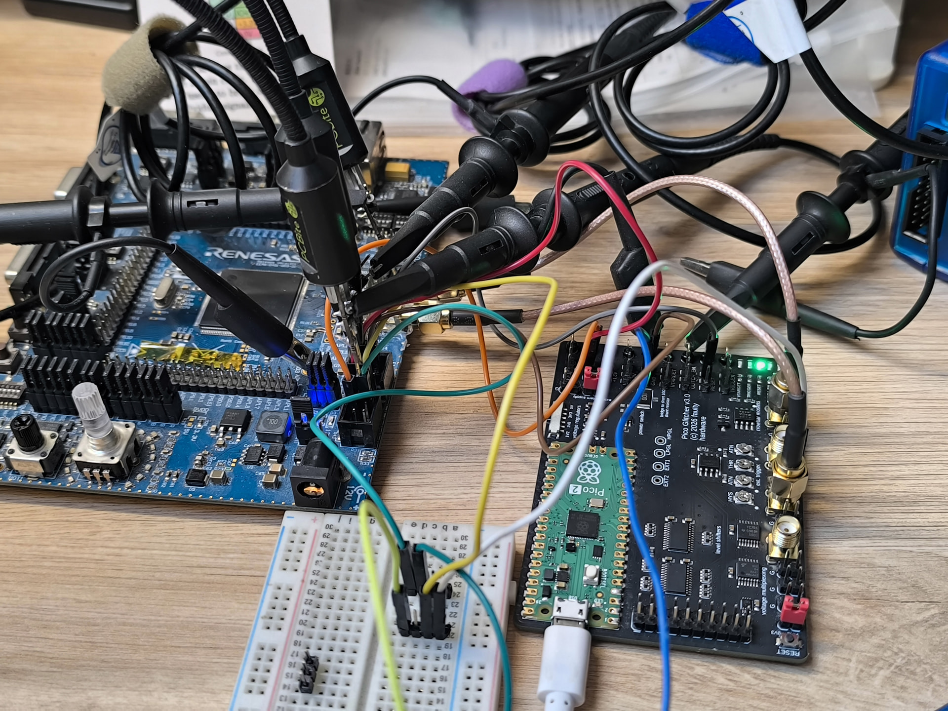

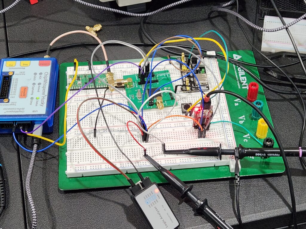

Validation on the Pico Glitcher v3
And this is where it gets directly relevant to me since I order the PicoGlitcher v3 to lower some attack costs -> to validate that the attack is reproducible with accessible hardware, they tested it using the Pico Glitcher v3, driven by by Matthias Kesenheimer’s findus Python library.
The Pico Glitcher v3 is based on the Raspberry Pi Pico 2 and integrates two high-power MOSFETs for crowbar glitch generation, level shifters, and adjustable Schmitt trigger inputs (EXT1/EXT2) -> these are what they attempt to use to detect the power consumption pattern on a budget.
The verdict: the spikes in the target pattern are in the order of a few millivolts, which is at the limit of what the Pico Glitcher’s Schmitt triggers can reliably detect. They work around this by directly modifying the Pico Glitcher’s MicroPython firmware (StatesMachines.py) to implement a custom sequenced trigger using PIO (Programmable I/O):
  1. Edge counter on EXT1 to track the UART password frame
  2. Calibrated delay
  3. Rising edge trigger on EXT2
@asm_pio()
def edge_trigger_threshold_rising_edge():
    pull(block)
    mov(x, osr)  # Read edge counter threshold
    pull(block)
    mov(y, osr)  # Read trigger #1 delay
    label("edge_count_loop")
    wait(0, pin, 1)
    wait(1, pin, 1)
    jmp(x_dec, "edge_count_loop")
    label("delay_loop")
    jmp(y_dec, "delay_loop")
    wait(0, pin, 0)
    wait(1, pin, 0)
    irq(block, 1)
    push(block)
Result with the Pico Glitcher: ~7,000 attempts for one success. Less efficient than the ChipWhisperer Husky (88 attempts), but it works -> and the hardware costs €30–50 🙂

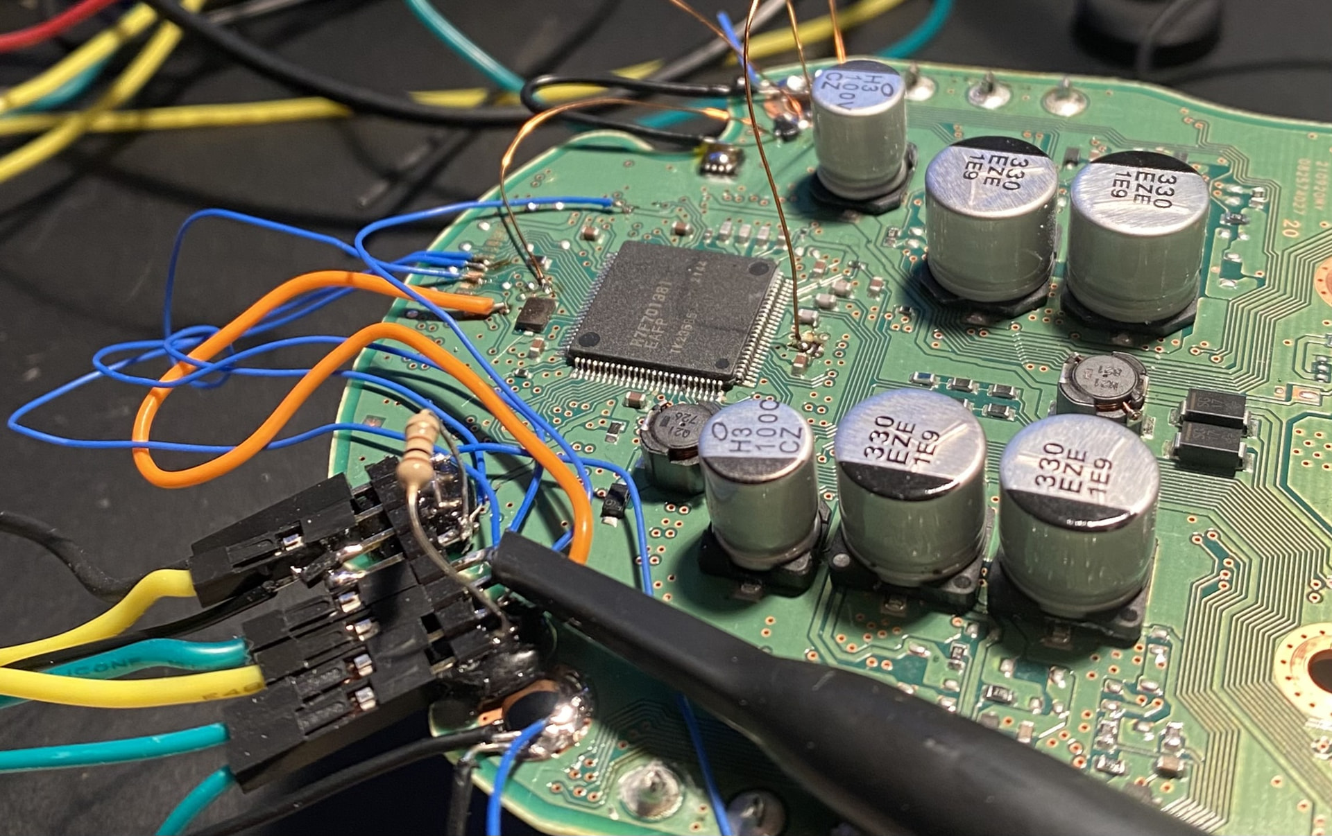

The BCM contains an RH850/F1L: yet another family member not seen in the other research, adding a 3rd distinct RH850 variant to the timeline (alongside the P1M-E and the F1KM-S4). They first tried to extract memory via the CAN interface, found it protected behind Security Access. Physical disassembly followed, then connectivity via the JTAG pins and a Renesas E1 debugger, which promptly asked for the 16-byte ID Code. Common codes were tried, all failed. So, same as everyone else in this timeline: fault injection it is.
Protocol analysis
They replicated the same 2-wire UART approach: FLMD0 pulled high, logic analyser on the lines, full decode of the RFP command sequence. Notably they document the exact flow clearly: sync zeros -> device info -> clock frequencies -> bitrate (9600) -> serial programming check -> ID Code Check command (16 bytes). Useful reference if you’re building your own tooling! 🙂
(source: https://jerinsunny.github.io/blogs/2024/02/14/rh850-voltage-glitching.html)

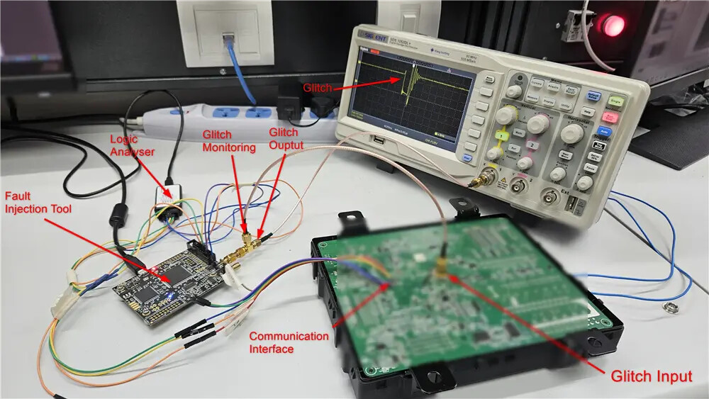

Hardware setup: CW Lite + a hardware mod
Here’s where it gets interesting. They used a ChipWhisperer Lite, the entry-level model, cheaper than the Husky used by CCSW and Quarkslab with the glitch output connected to ISOVCL.
Decoupling caps on ISOVCL were replaced (not just removed) with custom values chosen to shape the glitch profile more precisely.
The CW Lite doesn’t give precise enough control over glitch voltage levels out of the box, the crowbar was pulling too hard or inconsistently. So they claim having fixed the CW Lite circuitry** to regain voltage precision.
The post is a little vague about this modification, but it is worth to mention the CW Lite crowbar is binary by design. The most common fix for this is adding a series resistor on the crowbar path between the MOSFET drain, and the SMA glitch output to limit the effective short-circuit current, and produce a softer, shallower voltage droop rather than a hard rail-to-GND. A second possibility is that they modified the target supply voltage path, reducing VTARGET so that the same crowbar depth produces a proportionally gentler glitch. This is essentially what the Pico Glitcher v3’s 1.2V/1.8V/3.3V/5V multiplexed supply achieves programmatically.
