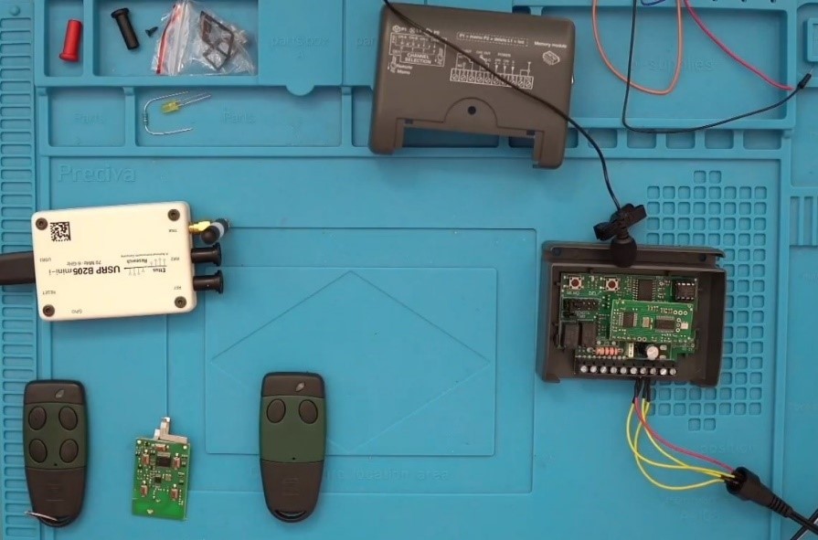

Figure 2. The setup composed of two garage Cardin S449-QZ2 test remotes and a Cardin RMQ449200 test receiver that will be analyzed against a USRP B205mini-i
The targets studied for this blog entry are Cardin S449-QZ2 remotes and receivers that support these remotes. We chose this remote because it was among several remotes that carry the DOR procedure, which we will elaborate on later. We used SDR to capture and analyze the signals sent by each remote button push. After rooting out the frequency range, we were able to use a custom SDR frequency analyzer and observe two spikes representing the signal we wanted to capture.
