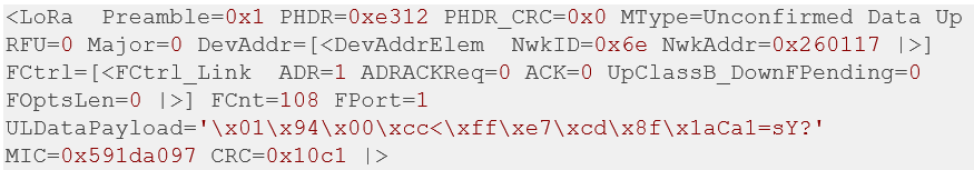

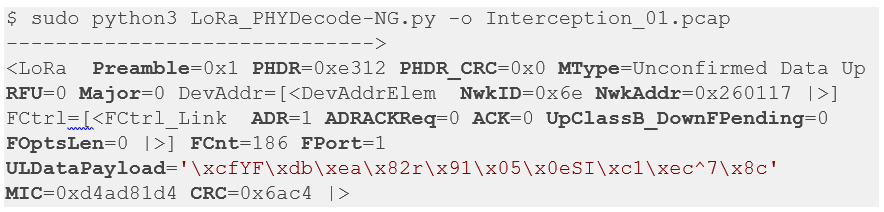

We can intercept LoRa PHY and LoRaWAN packets with our tool, but some are encrypted. The following packet is an example:
This packet comes from the devkit end-device we used to test these attacks, and it uses default session keys provided by Semtech.

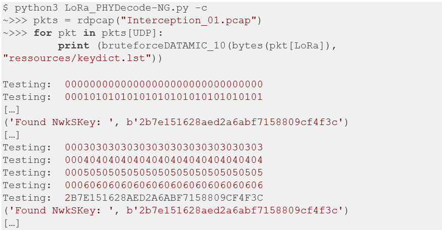

To check if the device is using a weak key to encrypt the communication, we have developed bruteforceDATAMIC_1x() functions (with ‘x’ depending on the version v1.0 or v1.1) to retrieve the session key used to compute the MIC depending on the direction (1: uplink by default, 0: downlink). This function takes a dictionary file path as a parameter. We have filled this dictionary with pre-generated LAF keys. This dictionary can also be filled with the default keys we got from the Arduino sketch for the LoRa shield.

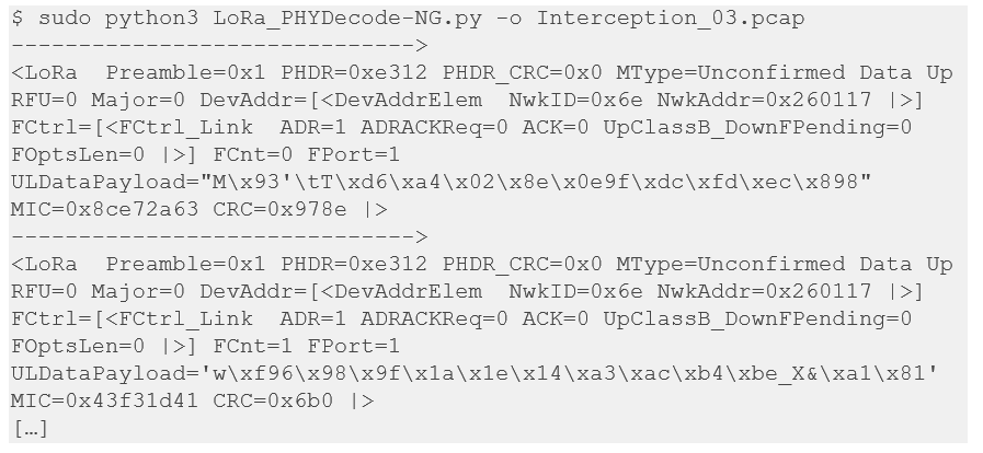

First, we save the packet into PCAP files as follows:
To assess the key, our LoRaPWN tool can be launched into interactive mode, which allows us to load the PCAP with the Scapy rdpcap() function and then test keys against a dictionary as follows:
And as we seen in the above example, the function bruteforceDATAMIC_10() found the keys for more than two recorded packets. So, if we use that key to decrypt these packets with our Python decryptFRMPayload() function we can see the following content:

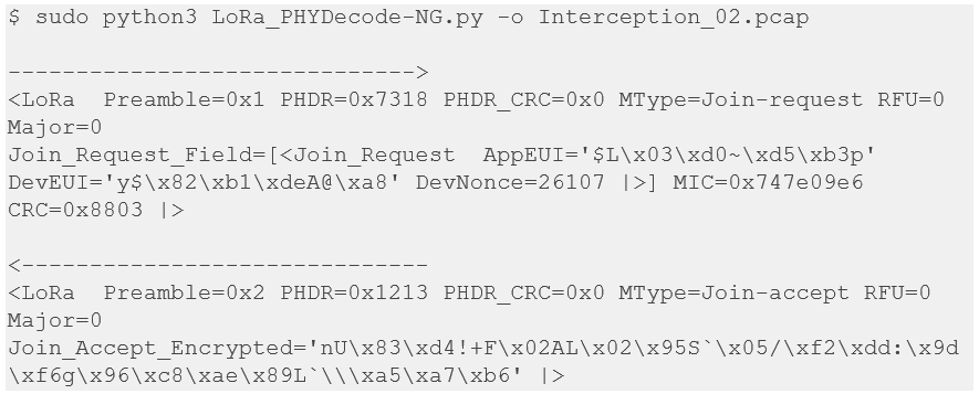

When intercepting OTAA traffic, we can see some Join procedure messages exchanged between the end-device and the gateway.
The Join procedure and the crypto mechanisms involved have already been explained in the first detailed article. In the case of the Join-accept message, the MIC is inside the encrypted payload.

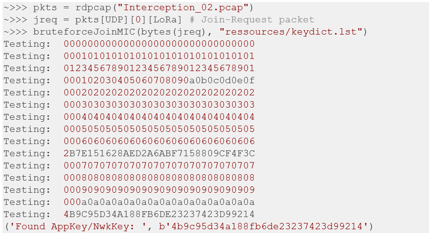

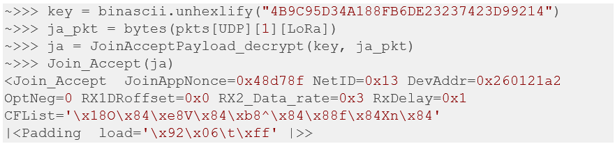

To bruteforce the AppKey on the Join-request, we have made a bruteforceJoinMIC() function that will bruteforce the MIC:
And so, with the key we can decrypt the Join-Accept message as follows:
This gives us the parameters of the JoinAppNonce value, which will generate the session keys to encrypt and decrypt the FRMPayload fields.

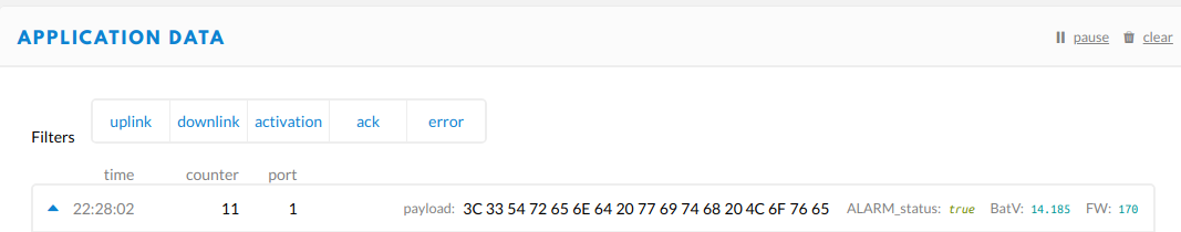

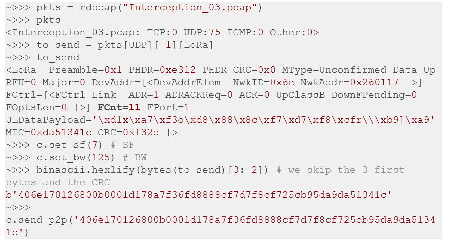

As gr-lora from rpp0 allows us to only receive LoRa PHY data, we demonstrate the injection part with a Microchip RN2483 devkit. However, any device that allows us to send P2P data can be used as well.
We first sniff ABP packets with an SDR device and then save the capture as a PCAP file:
Then we wait until the counter resets. When the counter reaches its maximum values and overflows, we can replay a packet with a high counter value using the devkit and the loranode Python library.
We can see that the packet we will replay has a counter with a value of “11,” so after sending it to the gateway, we can get the acknowledgment from the network as follows:
Figure 2. Acknowledgment of a replayed packet
The legitimate device will not be able to send its data until it reaches a counter higher than this value.
