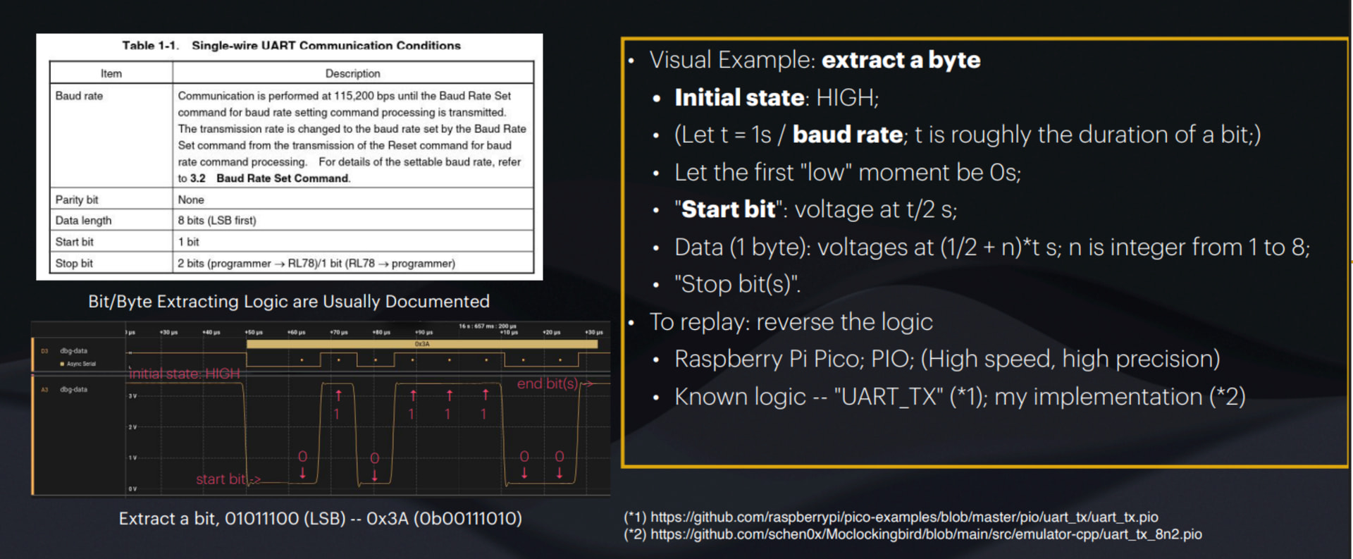

The first two parsing steps (voltage->bit, and bits->byte) are well-documented for commercial chips.
Chen proposed the following pipeline:

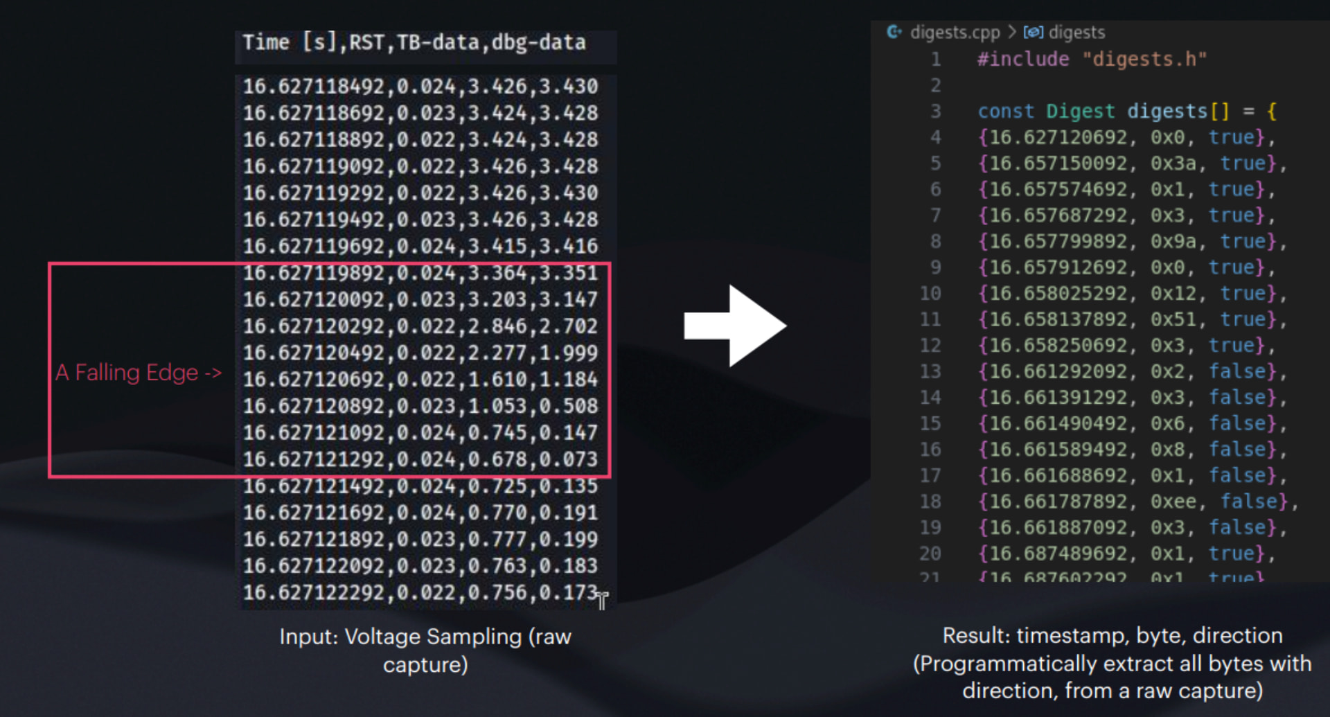

  1. Capture raw data with any logic analyzer (like a DSLogic or even cheaper with a SLogic) at high sampling rate (5 Msps), producing several GB of raw voltage/timestamp data,
  2. Identify rising/falling edges to reduce data volume,
  3. Apply documented bit/byte extraction logic (start bit, 8 data bits LSB-first, stop bits) to convert raw captures into timestamped bytes with direction
Extracting bytes
(source: Easy Fault Injection by Traffic Mocking: How to Hack Any Microcontroller with a Raspberry Pi Pico by Tongren Chen (Schen) at CODE BLUE 2025)
Result extracting data with timestamp and direction
For replay, the process reverses: bytes are transmitted via Raspberry Pi Pico’s PIO engine using standard UART TX logic. The implementation Moclockingbird/analyzer again programmatically extracts all bytes with direction from raw captures and the Schen made his own implementation on the Pico following the official example.

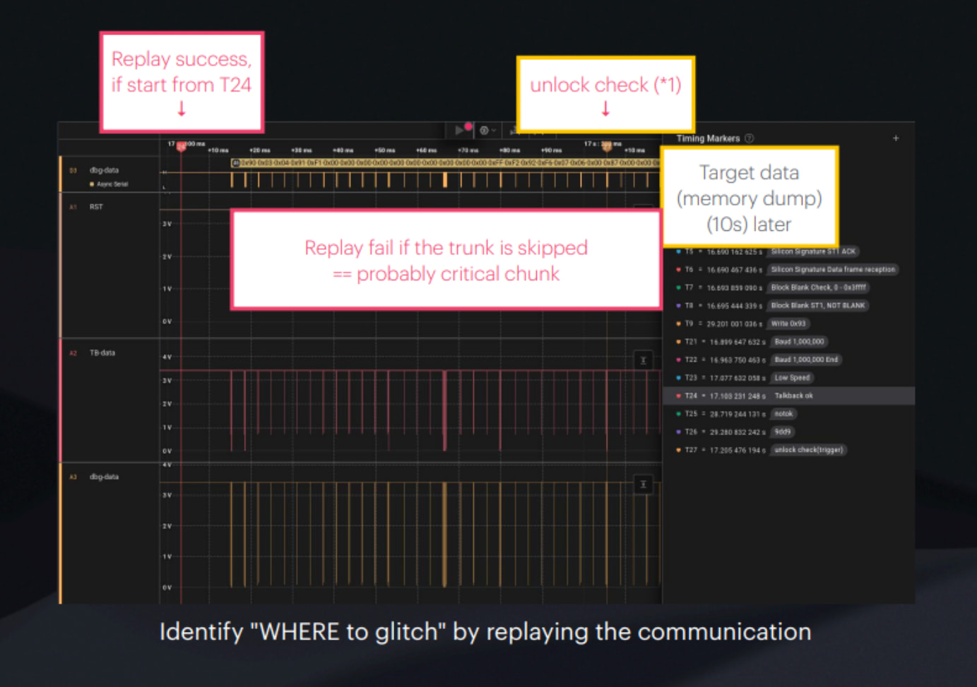

  1. Capture good traffic: set up a new/unlocked chip with an E2 Lite debugger, dump memory while capturing all communication,
  2. Identify critical chunks: replay from start to end (works), then progressively narrow down to find which trunks are essential vs. optional.
  3. Key findings:
    • a handshake trunk (including baud rate negotiation, documented in Renesas specs)
    • an unlock check sequence: debugger sends security ID (all zeros) + 0xFF checksum, chip replies with 1 status byte
  4. Digital trigger: since the attacker controls the send side, pause before sending the last byte of the unlock sequence sending that final byte becomes the trigger,
  5. Stop signal: compare traffic from successful unlock, failed unlock, and other scenarios on an unlocked chip. The success signal is 0xF2 (“Unlock OK”),
  6. Exploit commands: simply replay the trunks that precede the target data extraction with a little trick: prepend magic bytes (e.g., “9dd9”) to the firmware for easy locating of target data in memory dumps.

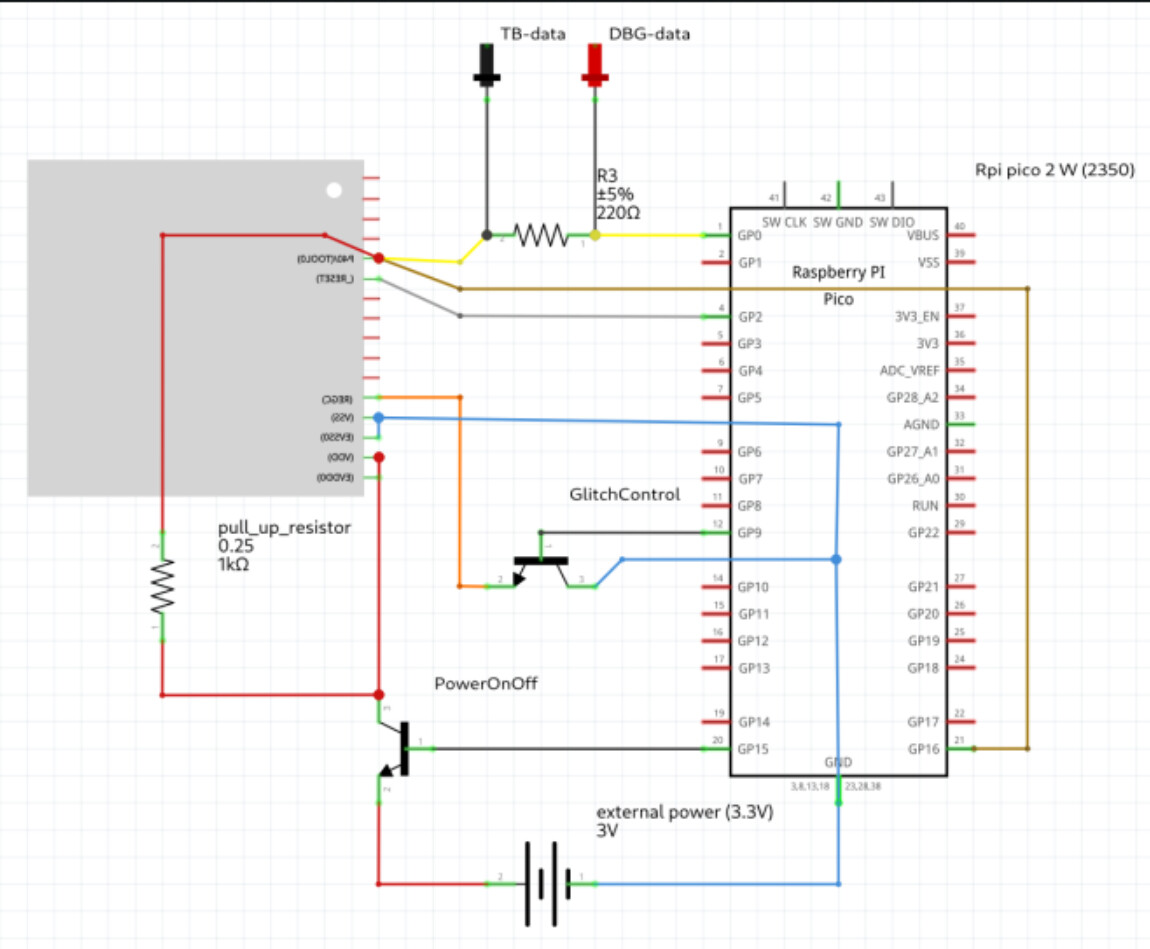

For that we need:
  • Raspberry Pi Pico 2 W (RP2350): Two cores, PIO engine with 9-instruction assembly set where every instruction executes in exactly one clock cycle. At 125MHz, the minimum on/off transition is ~16ns (2 instructions, 2 clocks),
  • Two NPN transistors (high-speed switches): either S8050D331 BJTs or FDS8949 MOSFETs,
    • Glitch switch: shorts the chip’s REGC pin (core voltage regulator) to ground when Pico briefly activates the base/gate,
    • Power switch: allows rebooting the target chip without rebooting the Pico (preserving glitch parameter state).
Note: More details can be found on the slides and the presentation on the wiring.
Interesting with the Pico is that it can run two programs with a neat accuracy. And more can be found about it looking at Stacksmashing YT channel there: In-depth: Raspberry Pi Pico’s PIO – programmable I/O!
So! Here is the Dual-core logic in action:
  • Core 0 (main): Runs task_tx0(): sends all traffic up to the trigger, signals Core 1, sends the final trigger byte, waits a parameterized delay, then fires the glitch
  • Core 1: Runs task_rx(): waits for Core 0’s IRQ, then continuously monitors the chip’s response, forwarding the first 2 received bytes to Core 0 for inspection
  • Core 0 checks if the 2nd byte equals 0xF2 (success). If yes -> replay data extraction commands. If no -> reboot target, adjust parameters, retry

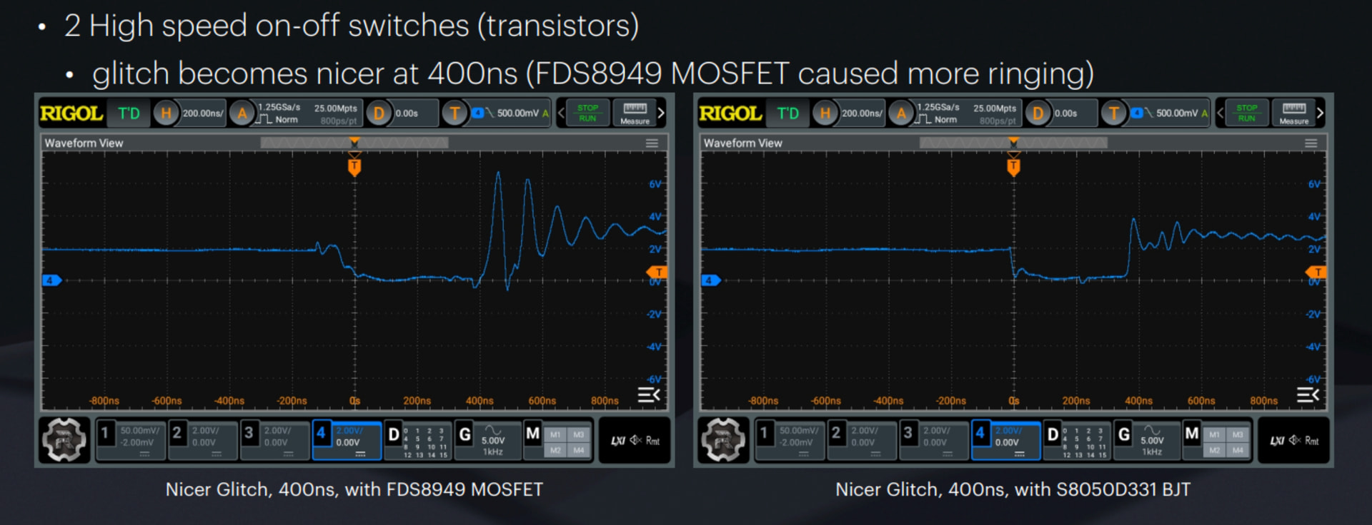

For glitch, two ON-OFF switches (transistors) were tested/compared:
  1. FDS8949 MOSFET: 150ns glitch -> nice but has some ringing and bit noisy; at 400ns looks better but need to use a a flyback diode component to reduce the ringing -> ,
  2. S8050D331 BJT: 150ns glitch -> better looking but still some ringing; at 400ns -> was cleaner overall.

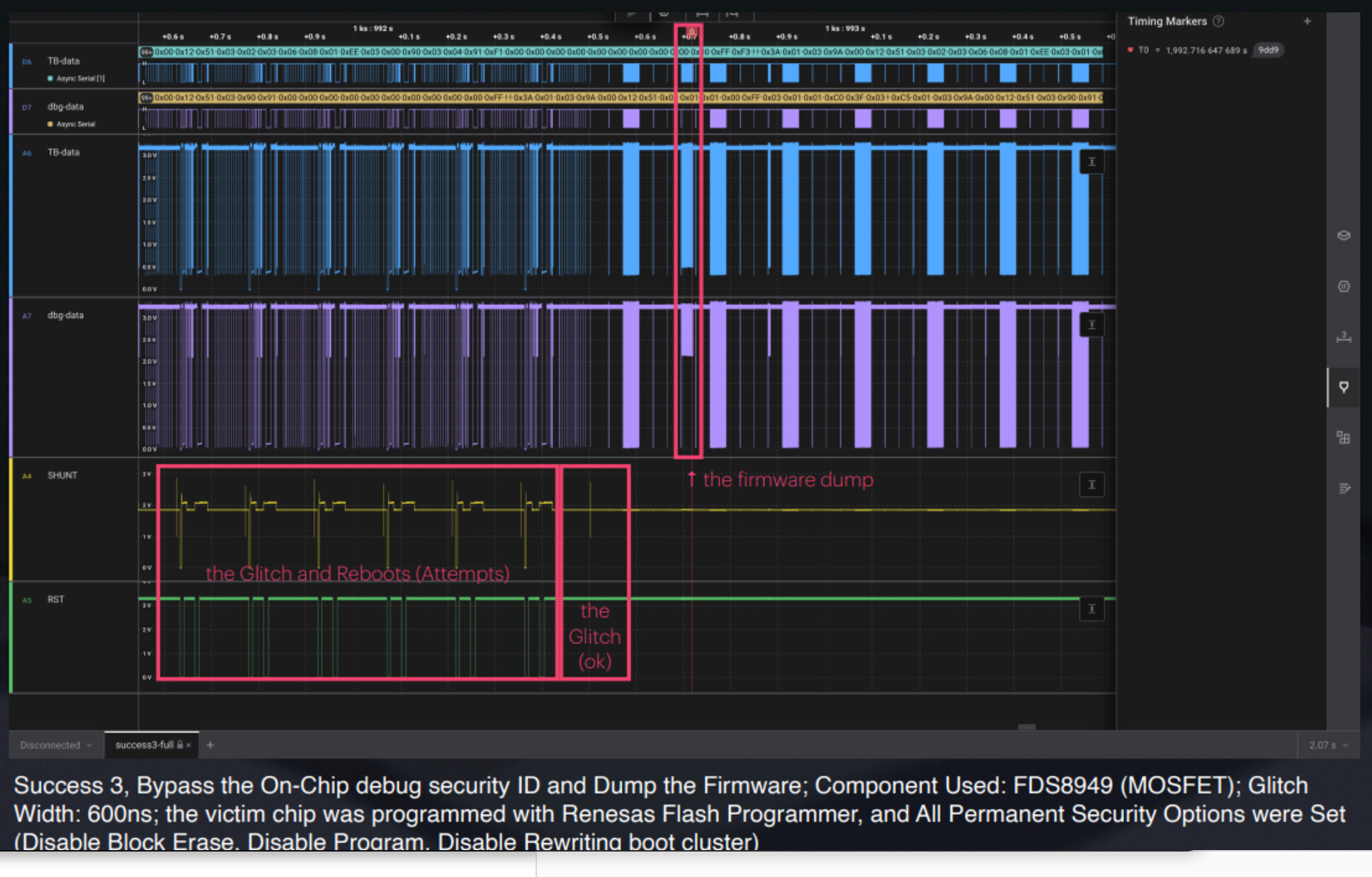

Then we are ready to:
  1. Glitch at digital trigger,
  2. Stop signal: if success -> replay the data extraction command (the lazy way), then stop execution; if fails -> reboot the target and use next glitch parameter and retry
  3. Then we dump the firmware with all permanent security options enabled (block erase disabled, program disabled, boot cluster rewriting disabled)
What’s valuable is the methodology: a generic, low-cost, target-independent approach to precise voltage glitching that replaces driver implementation with traffic capture and replay. For anyone doing hardware security assessments on microcontrollers with debug interfaces, this is a practical tool in the toolbox.
Successing the bypass of the OCD security ID

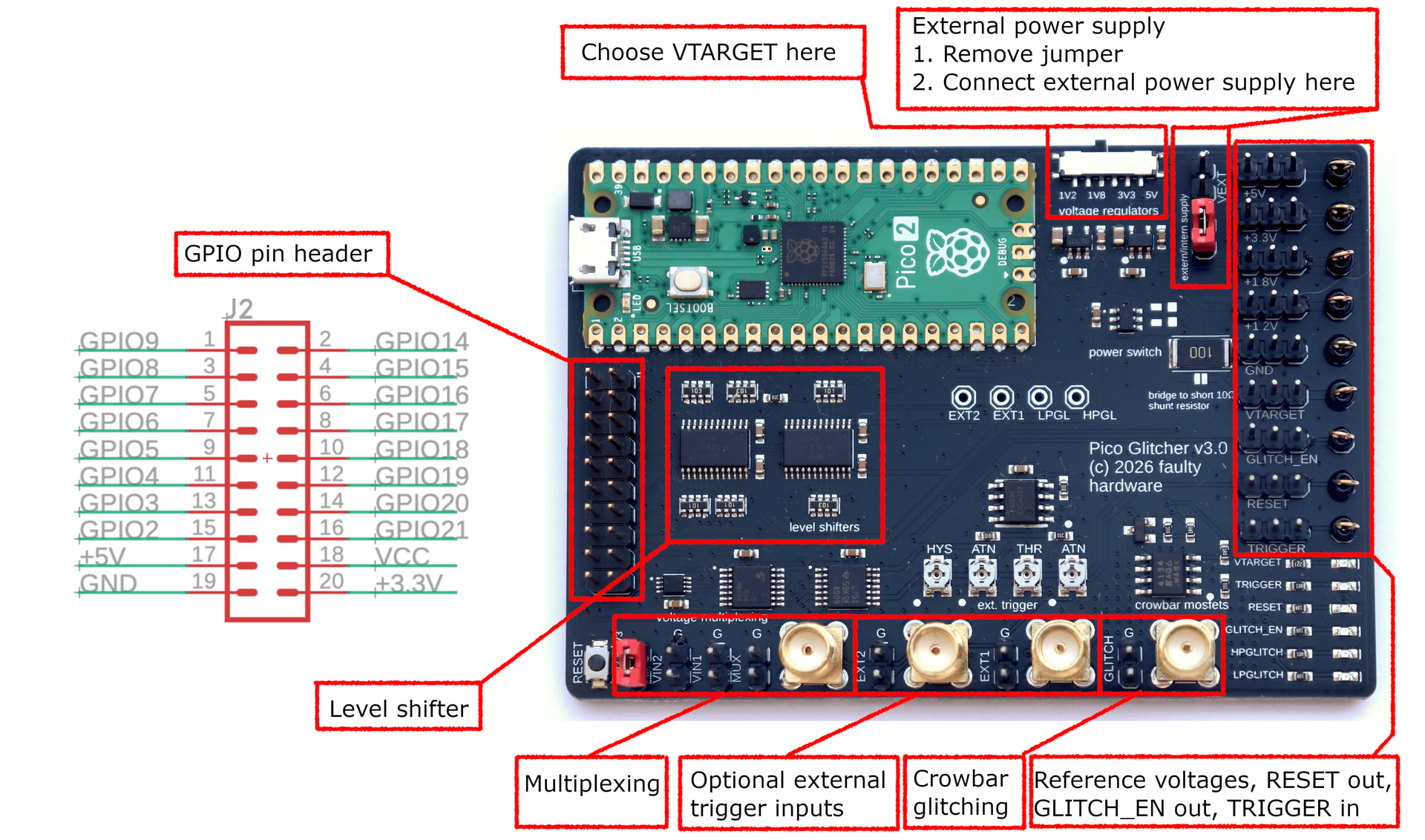

What about this instead?: https://fault-injection-library.readthedocs.io/en/latest/overview/#pico-glitcher-v3
Looks more feature-rich and flexible (pulse shaping, dual MOSFETs, Pico 2, richer software library). The Faultier is more compact though, and education-oriented and an integrated SWD probe. But with Schen’s technique we can also replay and dump everything with an extra SLogic or use the DAPLink mode of the SLogic to get the SWD probe too.
An addition to the stack with the Pico: https://community.penthertz.com/t/the-evolution-of-rh850-hacking-from-a-diy-to-the-pico-glitcher-v3/30
