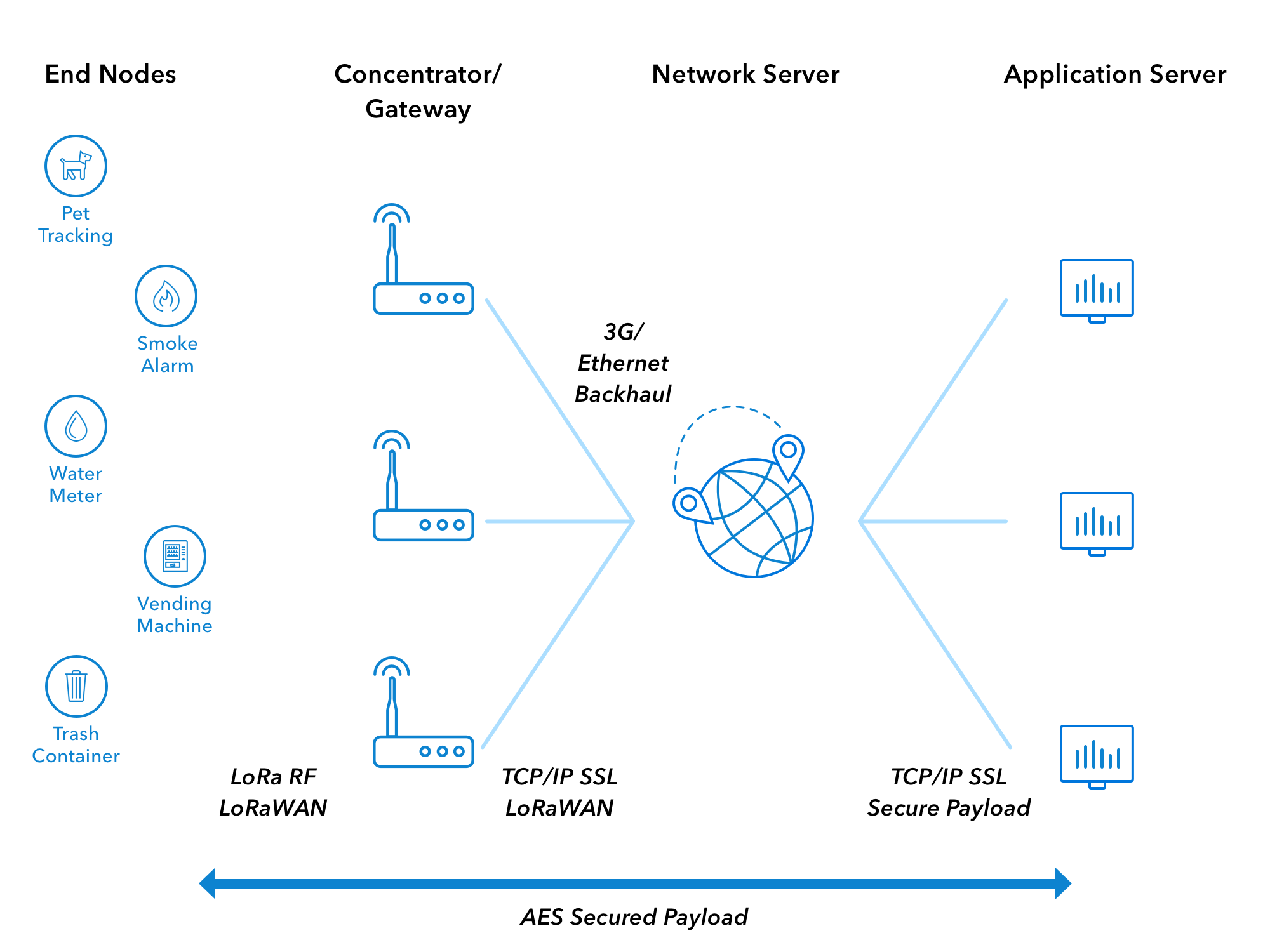

LoRa devices generally use two layers. The first one is called LoRa PHY, the proprietary lower physical layer. This part was made by Semtech and is proprietary, so there is no freely available documentation of this layer. However, Semtech has provided an overview of the modulation and some specifications. As this layer is proprietary and the only references are the provided specification, it is possible to encounter incompatible devices in practice.
The second layer is LoRaWAN, the cloud-based MAC (Medium Access Control) layer protocol. This layer communicates between LPWAN (Low-Power Wide-Area Network) gateways. The following picture shows the classic architecture of a LoRaWAN network:
LoRa Join procedure in OTAA
LoRaWAN architecture (source: https://www.thethingsnetwork.org/)
LoRaWAN is not mandatory when using a LoRa device. It is also possible to use raw MAC communication to send commands and messages directly like in P2P (Peer-to-Peer) for example. But in this case, 100% of the security remains in people’s hands, as it does not provide encryption and integrity as LoRaWAN does.

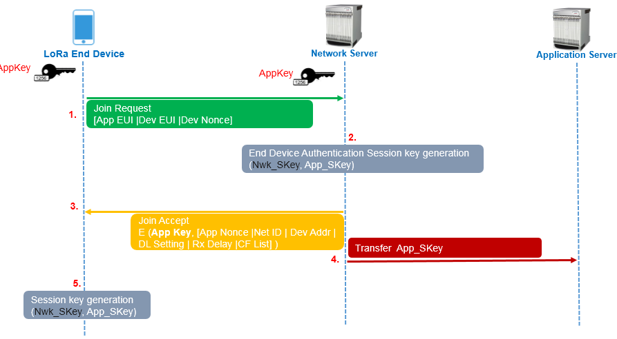

The preferred and most secure method is OTAA. Indeed, within this mode, a Join procedure is mandatory to authenticate the LoRa end-device:
LoRaWAN 1.0 Join procedure in OTAA (source: http://www.techplayon.com)
In this process, the end device first sends a Join-request with 3 parameters to derive the session keys:

If the device is permitted to join the network, session keys are generated on the Network side. After that, a Join-accept is then sent by the network to the end device with 6 parameters that are encrypted with the AppKey:

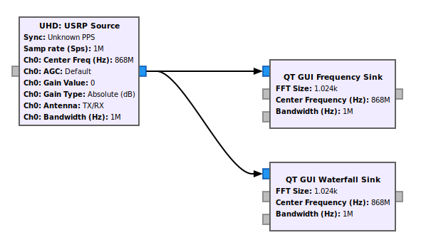

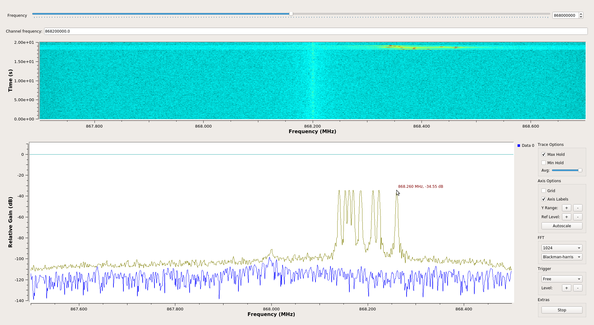

At this stage, we need to know the frequencies used by our target. To do that, we can use a waterfall to represent the signal across the frequency range and an FFT (Fast Fourier Transform) block to find the different frequency components of a signal. Here is a GNU Radio schema that can achieve that:
GNU Radio schema to find a targeted signal
In this schema, the sampling rate samp_rate can be increased depending on your SDR device. Of course, the longer it is, the more range you will cover, but then you’ll have to process it with your computer (be wise). Moreover, the central frequencies can be changed with a slider block implemented in GNU Radio to cover the different bands dynamically.
Note: The identification of signals can also be performed with tools like GQRX or other RF explorer tools. But for this post, we will keep using GNU Radio and evolve our schema to the end.

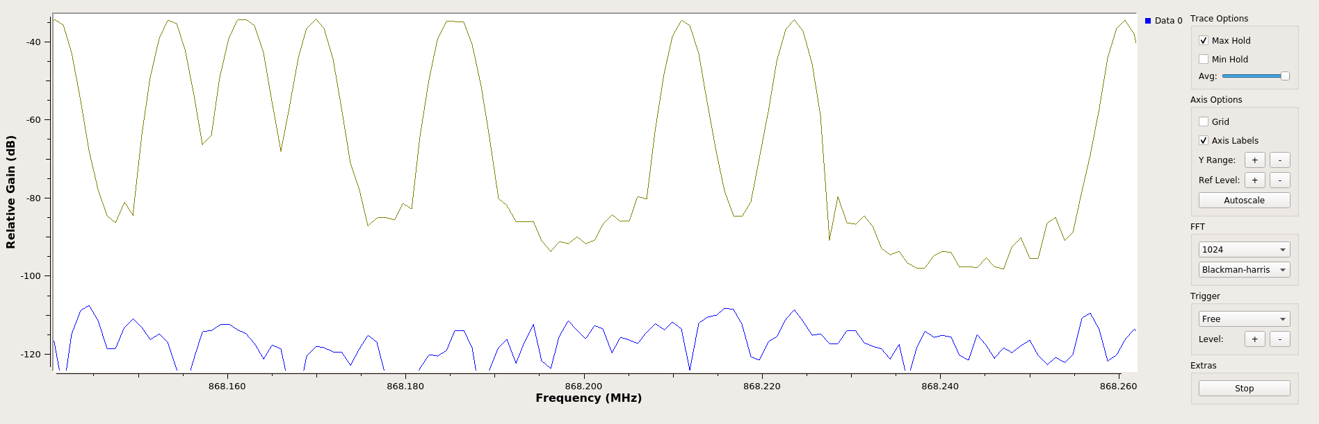

It is also essential to fill the Max Hold box on the FFT display to keep track of frequency components. Here is the result when a signal is triggered:
LoRa signal triggered in GNU Radio FFT and waterfalls
LoRa signal triggered in GNU Radio FFT and waterfall displays
In the above screenshots, we can observe that a signal was sent 868.2 MHz central frequency. Looking at the lower and highest frequency components of the FFT, this signal should have a bandwidth of 125 kHz:

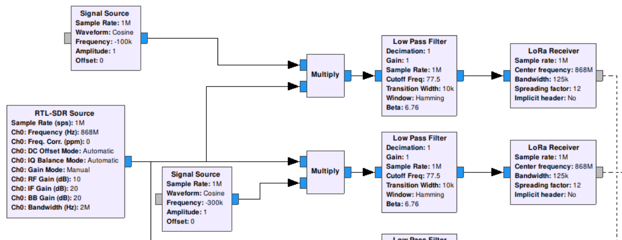

It should be noted that LoRa devices generally use multiple channels, and so it is better to identify all of them the same way before going further.

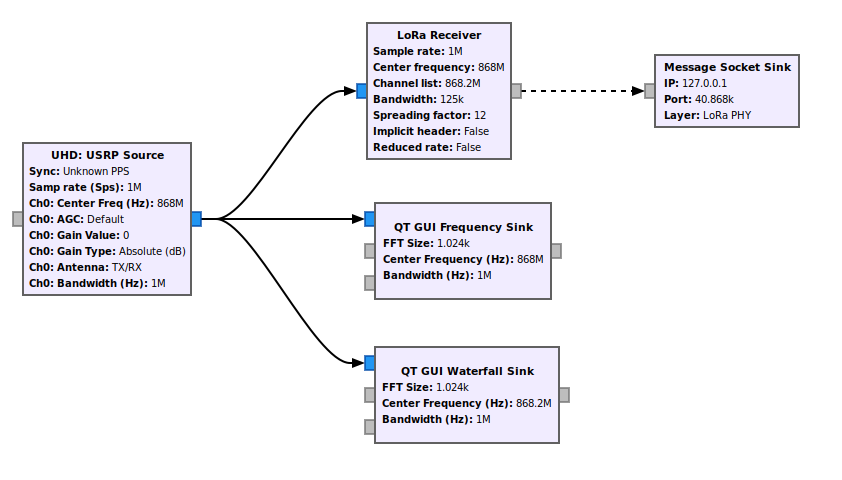

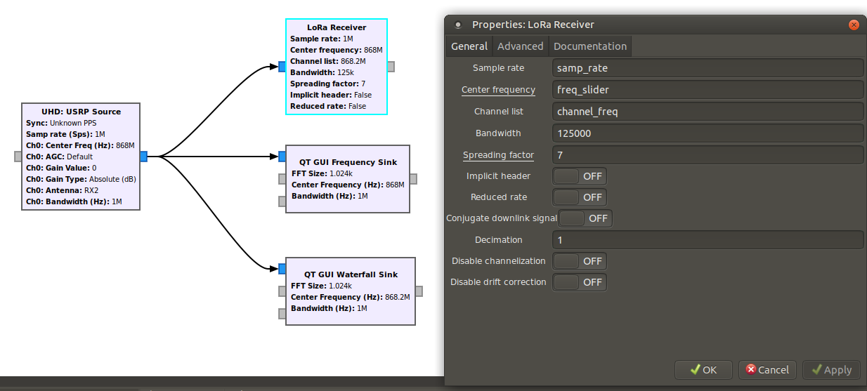

To continue, we add a LoRa Receiver from gr-lora to our schema, but at this stage, we have to fill different parameters:
Adding gr-lora to the schema
We already know the frequency channel used by our captured signal, 868.2 MHz, and the BW (bandwidth). However, there is still the SF (Spreading Factor) value left.

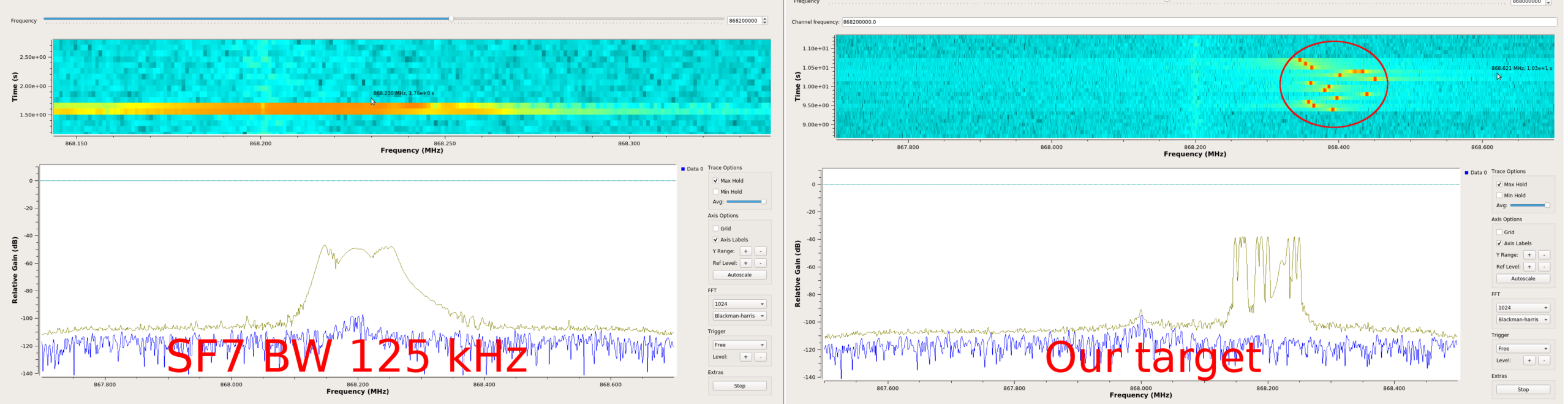

Naively brute-forcing this missing SF parameter is a way, among others, but we can think about more innovative moves. Indeed, as seen in the table above, LoRa operates with SF from 7 to 12. So the shorted chirp is SF7 with a data rate of 11 kilobits/s, and 12 the longest with a data rate of 250 bits/s. So by consequences, this will affect on time, and this can be observed if we compare two configurations, one with an SF7 and 125 kHz BW (on the left) and our target (on the right):
Comparing chirps with two different configurations
As shown in the above figure, chirps are sent faster in the SF7 configuration than our target, so our target probably uses one of the highest SF configurations.
So by changing the receiver to SF12BW125 configuration, we are finally able to see packets in GNU Radio console as follows:

The module gr-lora also implements a block to quickly send packets other UDP to an arbitrary host and port, so we will use to send packets to a port that will be caught by the Scapy sniff() function later:
Sending results over UDP
Using Message Socket Sink to send results over UDP

Testing OTAA and ABP keys
In OTAA, the Join procedure could be interesting to capture and brute-force MIC fields on Join-request messages. As we saw earlier, this MIC is generated by the AppKey in version 1.0 of LoRaWAN and the NmkKey for 1.1.
As an example, if we are able to intercept the following Join-request packet, we can test if a weak key like 000102030405060708090A0B0C0D0E0F with our lutil/crypto.py helper checkMIC:

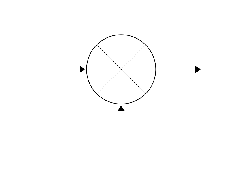

Optimizations based on heterodyne techniques
Heterodyning is a signal processing technique that shifts one frequency range into another. To perform that, an input signal (f1, for example) will be multiplied by a local oscillator (f2) with a mixer:
Heterodyne process
Frequency mixer symbol used in schematic diagrams (Source: Wikipedia)
In addition, to signal f1, this process will produce two additional signals f1-f2 and f1+f2. This technique is generally used in all modern superheterodyne radio receiver.
In our cases, we will probably face multiple channels and use many LoRa receivers to decode all LoRa signals in the selected bandwidth. So to reduce all that, we can probably use this signals mixing technique to shift downlink and uplink messages of a channel to the exact center frequency. Tristan Claverie and José Lopes Esteves proposed this idea in their article called A LoRaWAN Security Assessment Test Bench, published in the European GNU Radio 2019 book.
Note: To be more efficient, a channelizer would avoid making mixer for each channel, and also save computing time.
Heterodyne process
Schema proposed by T. Claverie and J. Lopes Esteves for European GNU Radio 2019
